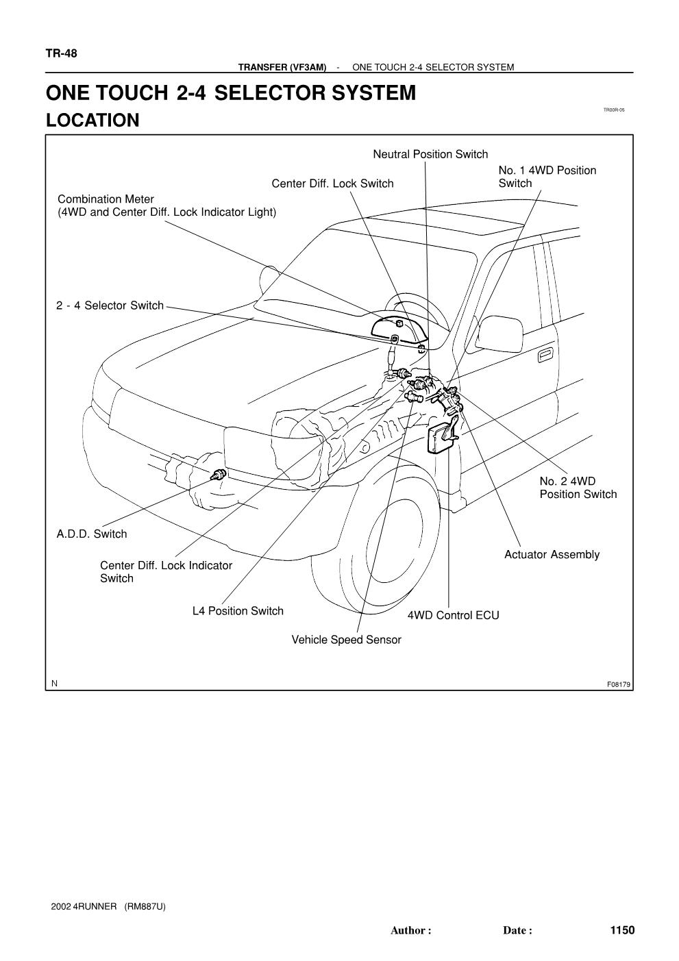

Okay, I'm cruising through my information and I see something you could check if you have a OHM Meter and wanted to get into more troubleshooting to determine EXACTLY what's wrong. I understand you're vehicle is not like my 2000 Limited Auto MANUAL 4wd. Correct?
I'm seeing a lot of different switches that all tie into the 4wd switching to your vehicle, I think. Here is the pictures i'm talking about, could be different than your's though.
