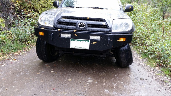

Have you checked your ball joints lately?
MtnT4R
Because seriously. Check your ball joints.

That's not yours is it Mtn?
Unfortunately it is. I was going through my phone and realized I forgot to post this. Happened a week after I replaced the driver side CV shaft and a bunch of other doodads, which is to say this mess effectively ate the money I had saved for new tires.
Being out in the middle of damn near nowhere, the fact that a scruffy redneck named Wild even bothered to help me is based predominantly on the facts that I had enough cash to bribe him, and that I also happen to be a scruffy redneck.
Apparently, there was some sort of force on the castle nut that stripped the whole bolt and sheared the cotter pin right off. We monkeyed around with 2 big ass crowbars and a sketchy aluminum jack for about an hour and managed to(barely) get a spare nut on that somehow kept it together for an hour drive to the nearest shop.
Neither Wild or the shop had ever seen that before, so I'm wondering whether it was a defective bolt or reckless disregard for mechanical upkeep on my part. The big positive to come out of this is, this happened about 5mph- if it had happened on the highway I probably wouldn't have walked away from that wreck. I had a few drinks when I finally got home that night :beer:
The most common cause for what you described is over-torquing. My money would be on someone over-torquing the castle nut, which deformed and weakened the threads past their elastic point.
Interesting, good to know. I found out after I bought the truck 2 years ago that its had several insurance claims filed on it- front end collisions. So evidently whoever worked on the car nearly killed me. Nice. I had the shop go over everything else on the front end, but they said it looked okay. Still makes me want to get rid of the damn thing though.
Most likely they just zipped them on with an impact wrench with no concept of proper torque, or concern for the problems that can cause. If tight is good, then tighter is better, in their uninformed minds. I refer to those types as 'Parts Changers', as they are not qualified to be referred to as Mechanics.
