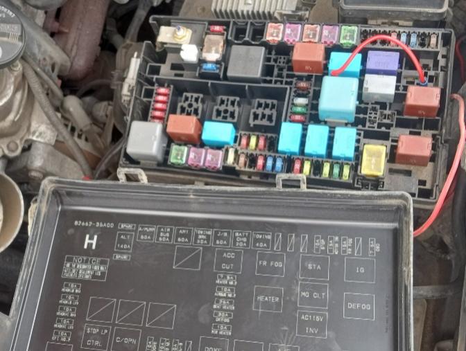

Have you tried other accessories, such as the radio, that should normally have no power when the ignition key is removed? I'm thinking you might have an ignition switch problem.
Welp that can't be normal.
Looks like a jumper from one relay to the IG spot which is empty. Assuming that's an ignition relay..
Never even opened that panel in my 6 years of having the SUV. I guess I'll buy a relay for that spot and see what happens.
Thanks for the tip to check in there.
no point of putting a relay in that spot, also someone did the fog light mod for you already.
Nice. I wonder if they ever were on here back when they had it. That would be interesting to find.
I thought my fogs stayed on all the time by the switch and didn't go out with hi beams and didn't understand why some had to mod theirs.
