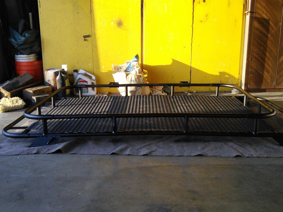

pictures of roof rack build

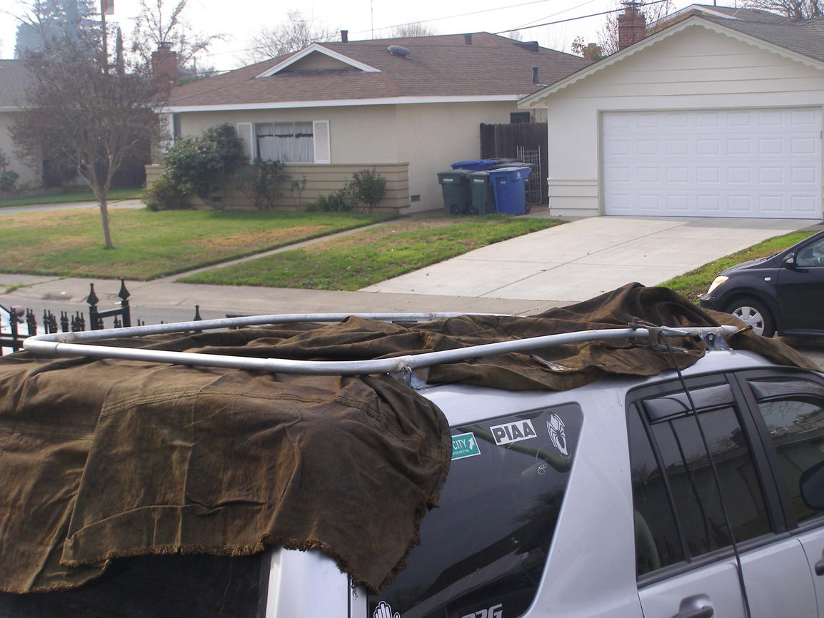

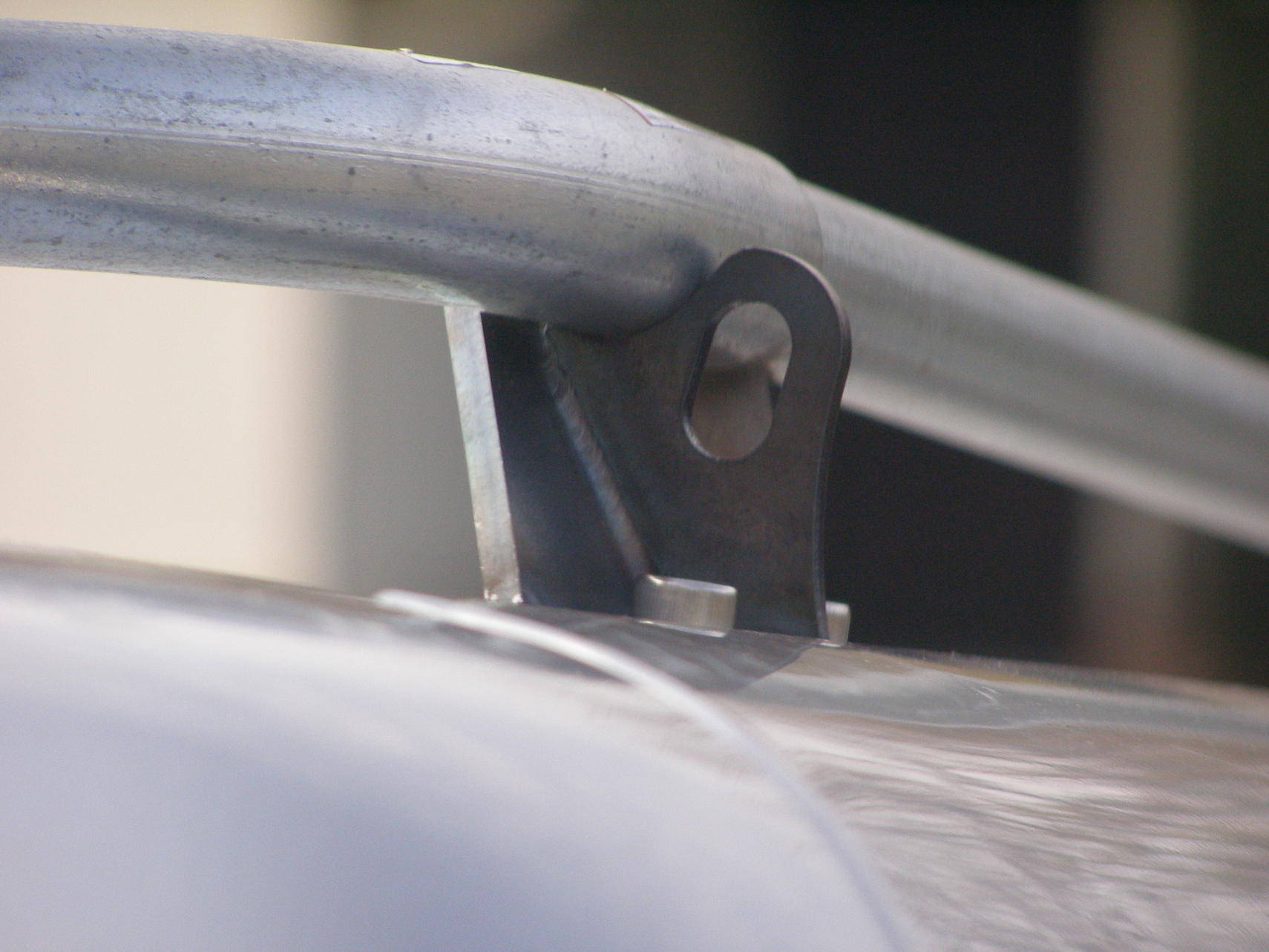

Since the all pictures won't post up on the rack I build, will have to do individual post.
Test fitting and tacking to the feet had to use my roof for a jig.

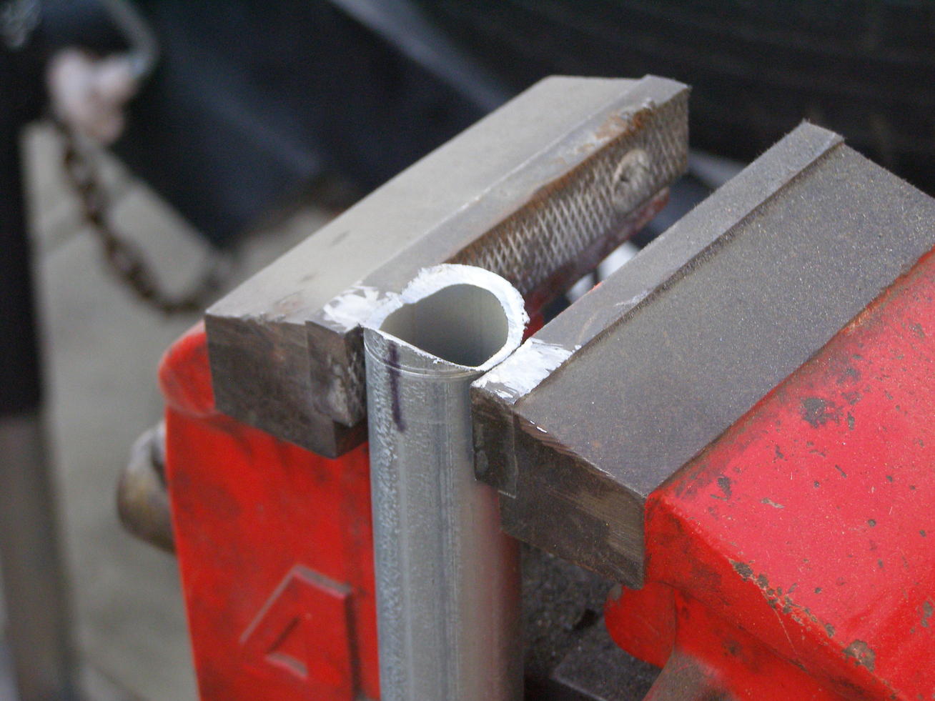

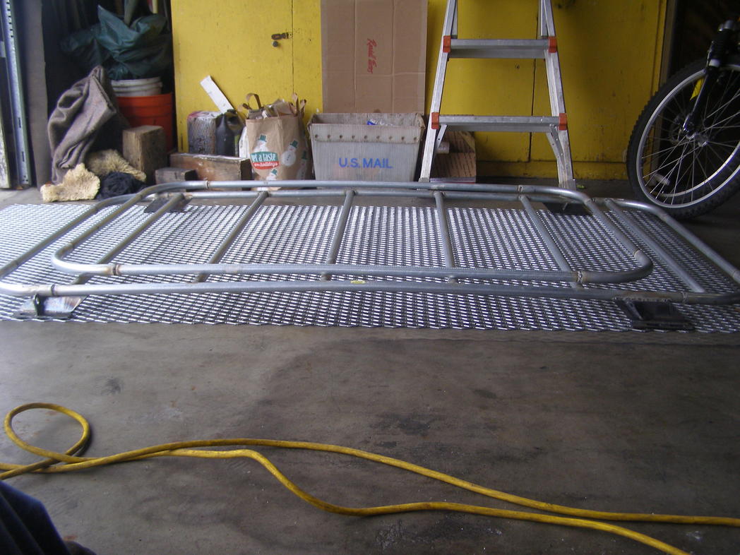

continue rack
This is where it took a lot of time to make all these notches to put this together. I used galvanized expanded steel also.

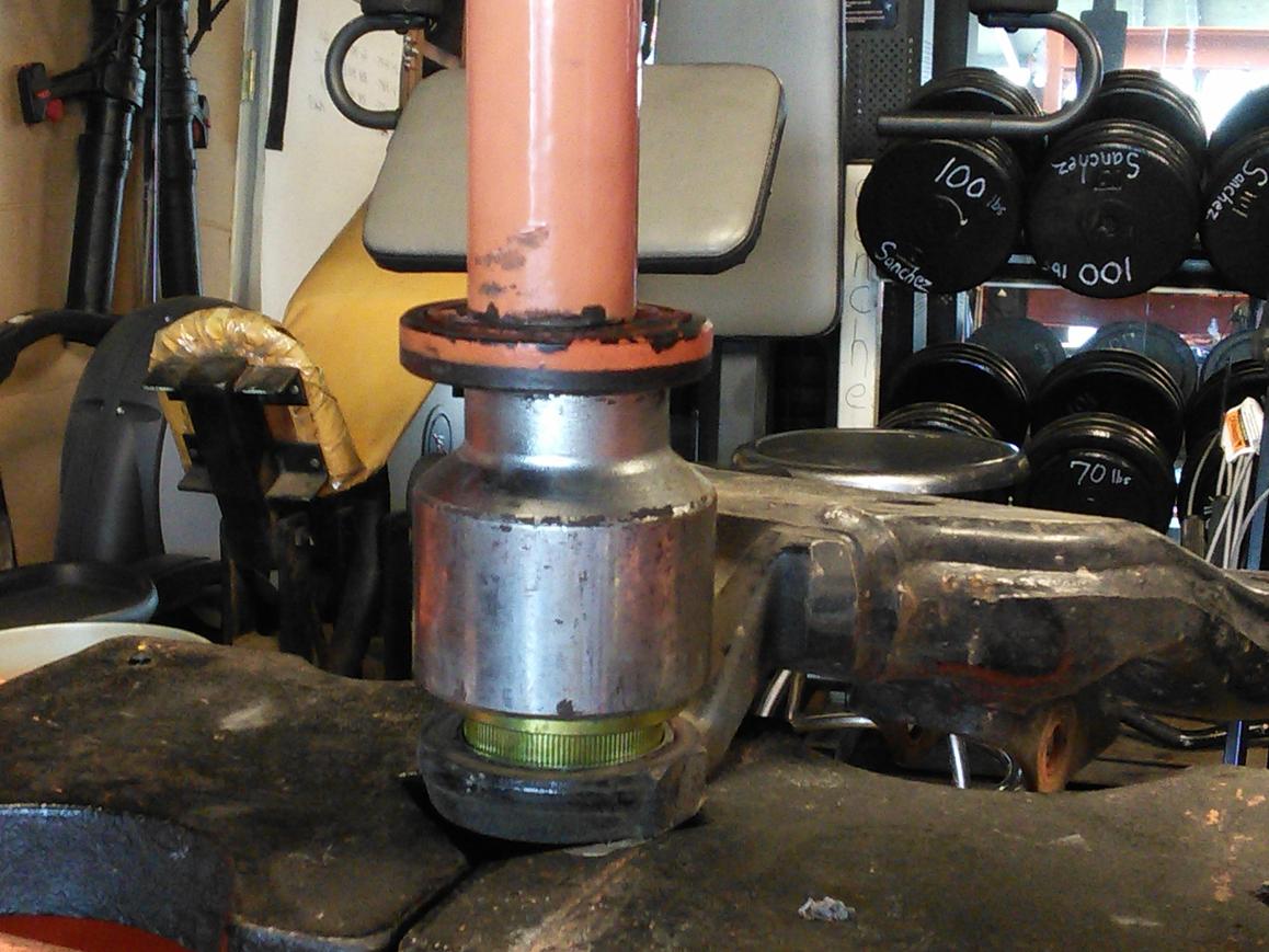

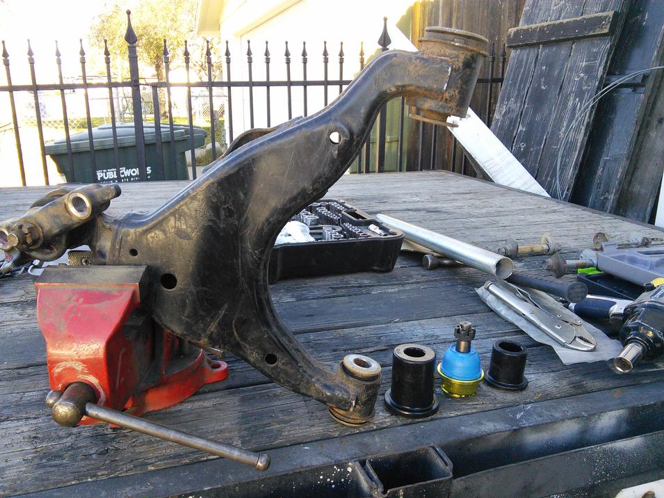

Got some creaking sounds coming from the front end on compression. So decided to change out the LBJ, decided while I have the LCA off, let's change out the bushings.
Greaseable bj, poly bushings, bushings when smooth and easy, bj, not so much. Neighbor has all kinds of presses in his garage, dayum 20t. press didn't even break the seal. Got to remove next weekend and have a shop press them.
New ball joints going in, went with the Raybestos 505-1435 as they are greasable and are built as a solid ball assembly like OEM. 108k.

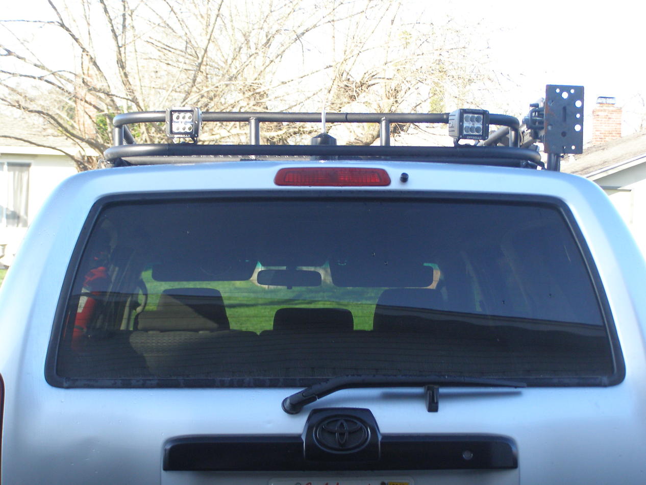

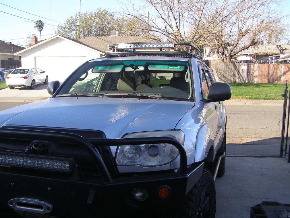

Extra Lighting
Since I have the roof rack on and all naked up there and saved a bundle by making it myself. Welded a high lift jack mounts to it, and installed a 30" curve combo and a couple of 4" floods in the rear. Installed a inside fuse box to run these and anything else in the future.

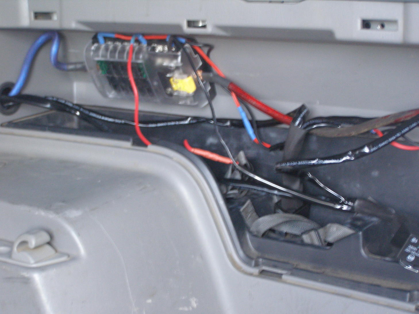

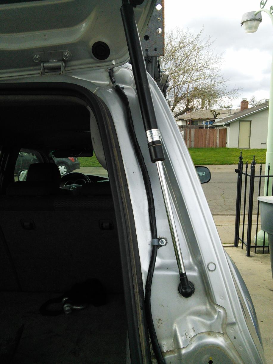

question on wiring and where you ran the wires as I'm thinking of some side mounted lights and wondering if you brought the wires down the windshield or through the back hatch?
I came through the back hatch area. Pictures are on my camera at home, will post up the wiring locations this weekend for you.
Had a request for where I ran my wiring for my lights, so I guess I'll put this in the build.
Since I bought this not to look pretty going over the summit. And since I'll never get rid of this ride unless too much to repair, destroy it on a run, and if either case, sell it for scrap metal, OR I DIE, which ever comes first.

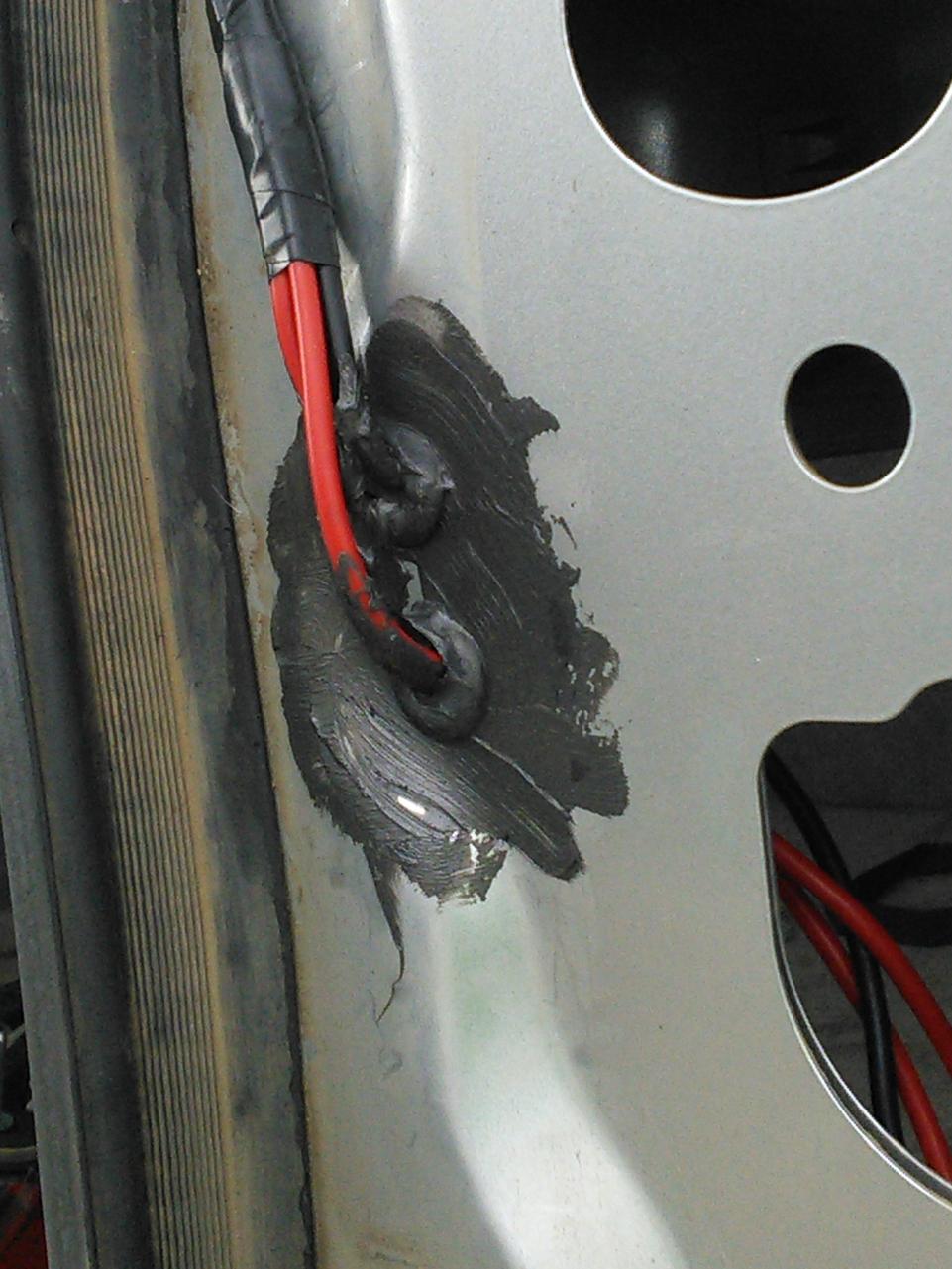

The location on the wires going in has a double wall with 1/4" space between them, so used some grommets on both sides and used some silicon to seal it.
As you can see also, used wire holders and self taped them to keep the wires from moving around and rubbing on the rear door, silicone them. I just put another layer of silicon an all spots to complete any possible leakage.
My roof top antenna was done in this manor also, 5yrs and no leaks yet.
[MENTION=84680]wadle5[/MENTION]...
