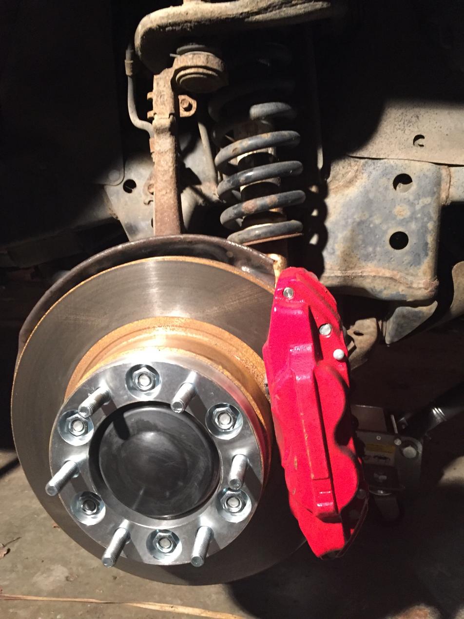

I also bought calipers, rotors and pads so I could do the Tundra brake upgrade. I instantly regretted buying a 4Runner from the coast. Everything was seized up and a giant pain to remove. I finally got it brakes swapped and it was totally worth it! She brakes so much better now and the vibration while braking is gone. I also put in a K&N air filter and removed the running boards too.

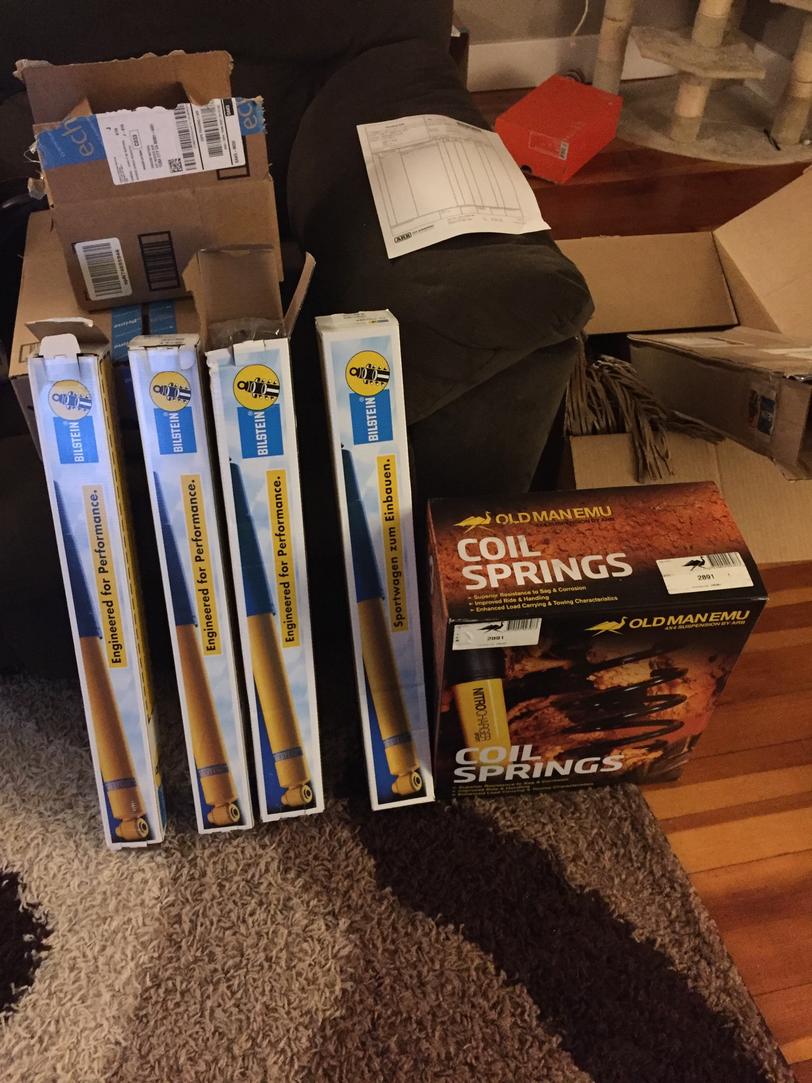

I put about 1000 miles on her and decided the suspension is shot and started looking at lifts on here. After reading who knows how many threads (The amount of knowledge on this site is crazy) I decided to go with Tundra 5100s front and rear, toytec/eibach springs up front and OME 891s in the rear.
They love that I decided to put a new lift on and have been getting new boxes almost daily
