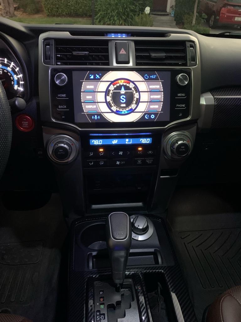

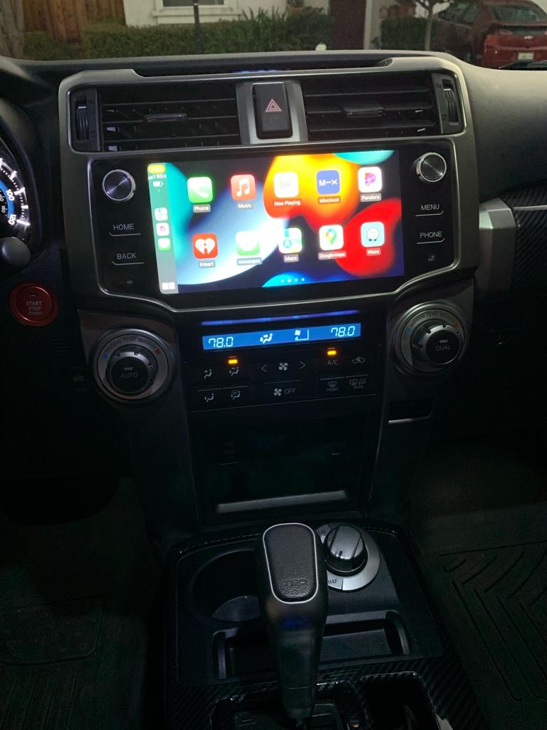

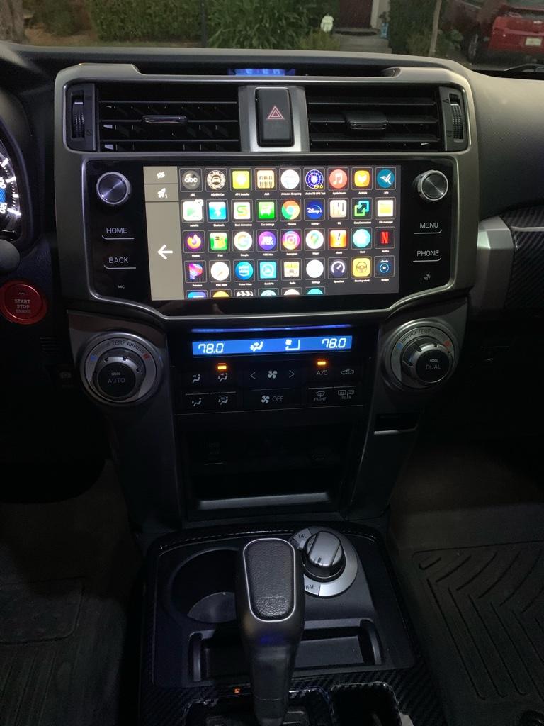

CTH T10
Join the "CTH 4Runner Android Head Unit Owners" facebook page. I was on the fence until I did this and realized that the support community for these units far exceeds anything else available.
Its an android tablet basically with an amp. It's not as intuitive as an off the shelf name brand unit but the capabilities of the unit are only limited to what the internet has to offer.
I wanted something simple but a large oem looking screen with android as well as wireless CarPlay. I also have a limited w/JBL. I choose the Cth T9. it’s an amazing HU with tons of possibilities.

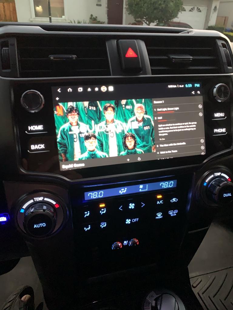

Netflix is perfect when sitting in the truck waiting [emoji1417]

Installed my T10 last week. I love it so far. I bought it to have a better Bluetooth & Android Auto option, so I doubt I'll use it for all the other options. Looks OEM, easy installed. The facebook group has a really good support system on it. They're pricey...around $580 or so, but as much as I drive, I wanted an updated headunit.
