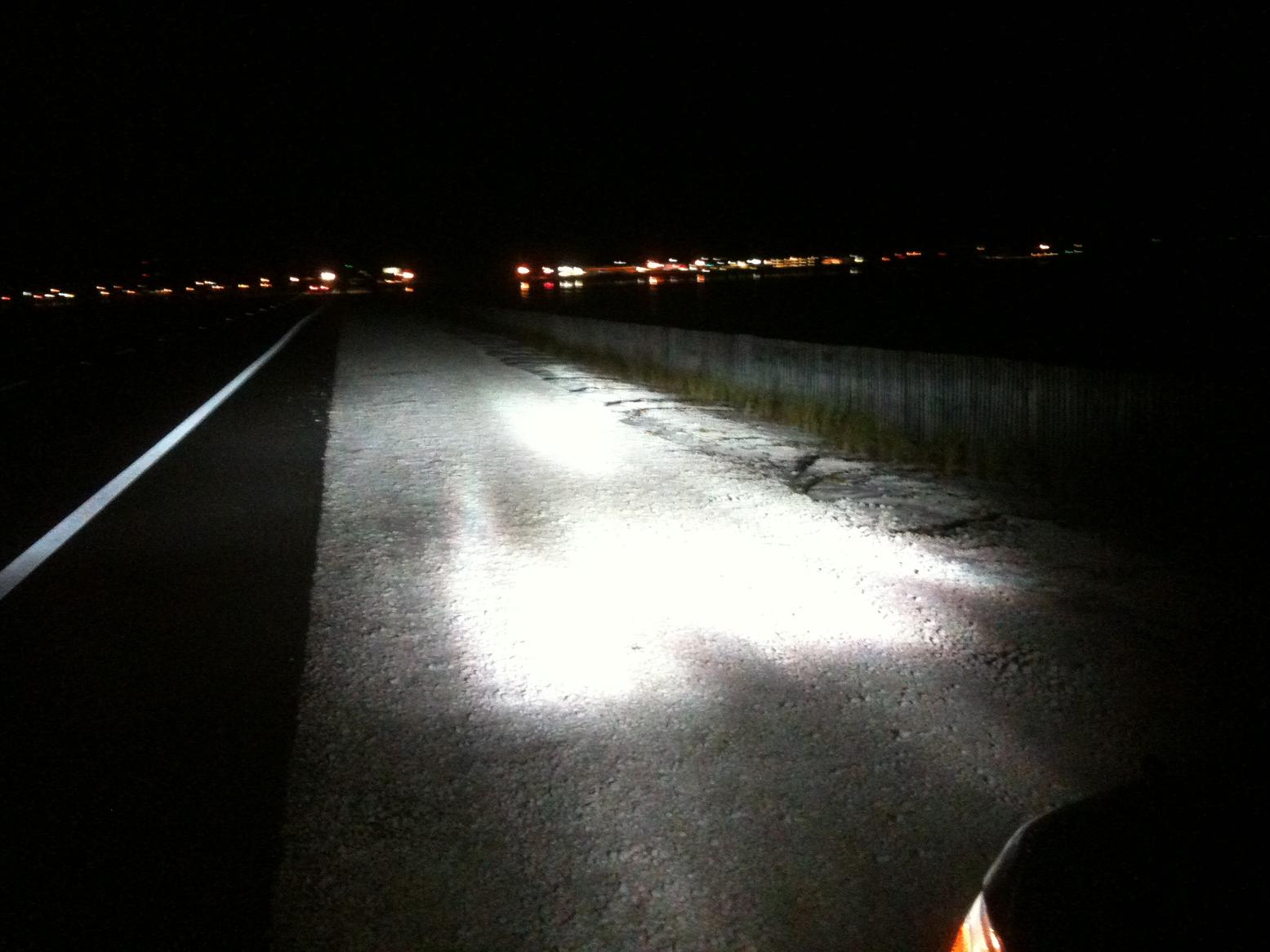

New JDMs (same 6000K HID kit in both pics)

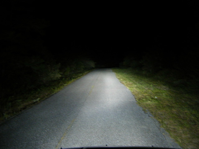

Old 97 factory lenses before they got filled with mud.

Jon, your HIDs look a whole lot brighter, but your stock headlights seem to have a much further range.

I've pulled them up since the pics. Same range just scattered light. I'm going with some 7" off roads when I get my new bumper.
