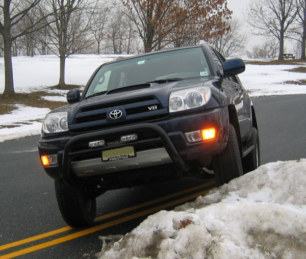

Just wondering how the headlight managed to move from being even with the other one.
Now, on that note, is there a way to re-adjust it to match with the other light?
Someone might've bumped your car.
There's a screw behind the headlight for vertical adjustment (up and down :p) but I haven't found one for horizontal adjustment. You need a 6mm socket or wrench.
