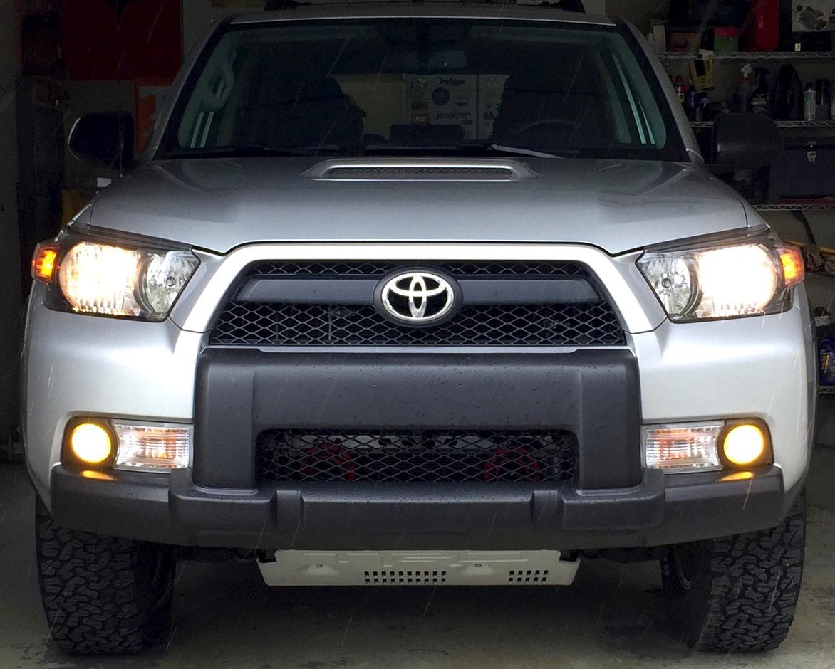

Because of the poor brightness of the H11s, I was going to go the Phillips Extreme/Sylvania Ultra route but the price and longevity of the bulbs was a concern. So, instead I did the H9 conversion using the Sylvania basic H9 bulbs... cheap. The difference was night and day and I feel no need to upgrade to anything else for night driving. Below is a pic of mine in the daytime when I was installing the H9s (driver side H9, OEM H11 on the passenger side). As you can see, the driver side is definitely brighter and not nearly as yellow. I took this pic in March of 2016 and have not had to replace a bulb yet.

Thanks for sharing, i'm pretty sure this is what i'm going to be doing this weekend.
You will definitely see a difference. Even more so with some high-end H9s if you can find them. I could only find the basic ones but they are good enough.

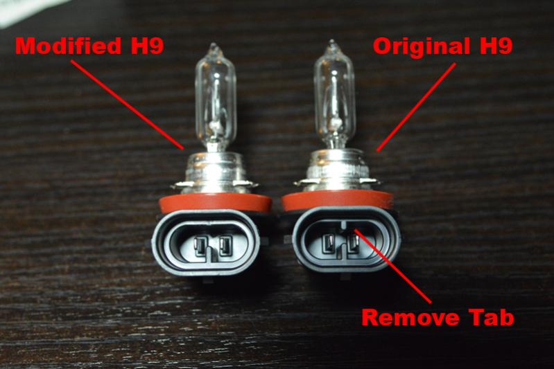

I had some trouble too. You need to trim the plastic mount and center metal tab. See YouTube. Fit and output is great once you trim correctly.
neither.. retrofit a h9 by simply cutting a small part of the tab and cleanng the glass throughly w/ alcohol. OEM H11's put out about 1300lumens vs h9's around 2000 lumens. Yes the h9's burn out faster than h11 just as the silverstars and xtremevision will burn out quicker as well. However h9's wil cost you a fraction of what you'd pay for those fancy bulbs.

They fit just like the H11 as long as you remove the little tab at the top of the plug. Other than the tab, they are the same shape. But yeah, it's easier to just buy an H11.

Actually, there’s a difference in metal tabs too, I had to trim center tab by 3 mm.

Oops. I forgot about that metal tab part since it's been almost 3 yrs ago.:redface: I used a little pair of side clippers (like those used for circuit board assembly) to cut the plastic tab and the metal tab. It probably took about 5 mins a bulb and they both fit perfectly. I just didn't want to spend $40 to $60 bucks for a couple of short-life bulbs. I've ran Sylvania Ultras and Phillips Extreme in other vehicles and even though they last a year or so it seemed like I was always replacing them. Good luck with yours. :thumb:

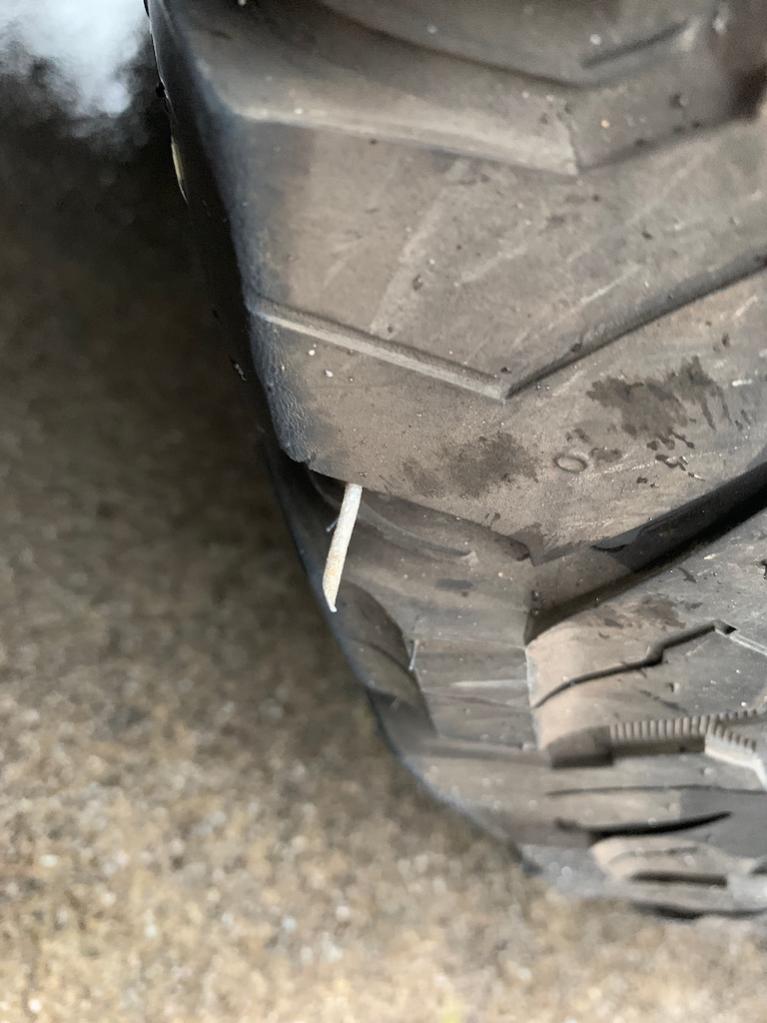

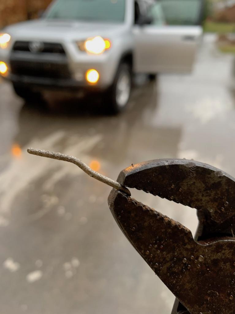

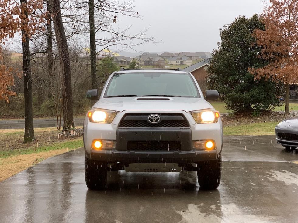

So after bragging about how long the H9s lasted (about 3 yrs), I had one go out a couple of days ago. I bought two more Phillips H9s, the "OEM quality" ones, did the modification and installed them. The modification literally took about 1-2 minutes per bulb. Now, I've got 65W of brightness to last hopefully another 3 years. And I also pulled this nail out of my tire... luckily not deep enough to leak.
