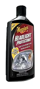

i gave up on using the headlight protectant after polish, it just never last, i just have my tint guy, do a complete polish and he had some left over ceramicpro, and he applied that over the lights, so far its looks new, the only way to keep the lights from hazing again is to apply a good coat of uv protection, opti-coat and ceramicpro is good, there maybe another option out there like clear coat, but aslong you have a good proteactant, itll be fine.
