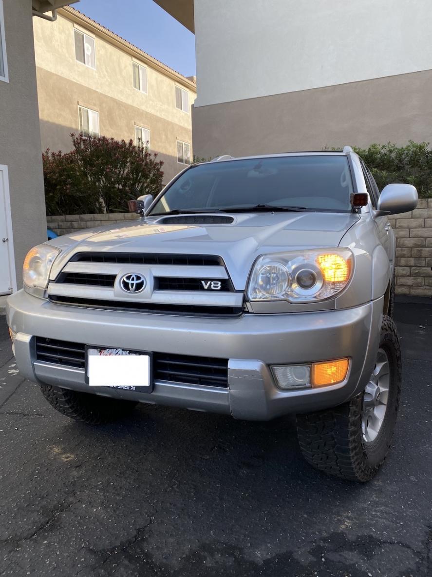

Hey! I have an 04 SE 4WD. Same problem with the "lamer" headlights. I converted to the 06-09 Projector housings and I've been very happy with the sharp cutoff and better lighting. Here is the link to the tutorial here on T4R: How to do the 03->06 Headlight Swap.
Its complete with a list of the steps, parts, and tools needed to be successful. You'll need new bulbs, a pair of harnesses, the trim pieces under the lights and new housings. If you're patient, you can find used housings for good prices (found mine for $50 shipped).
