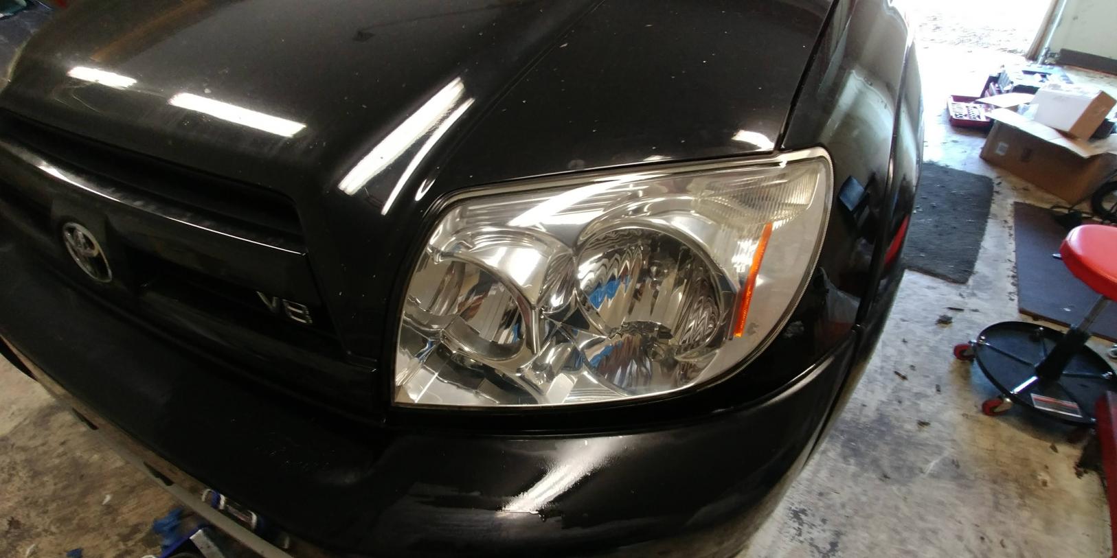

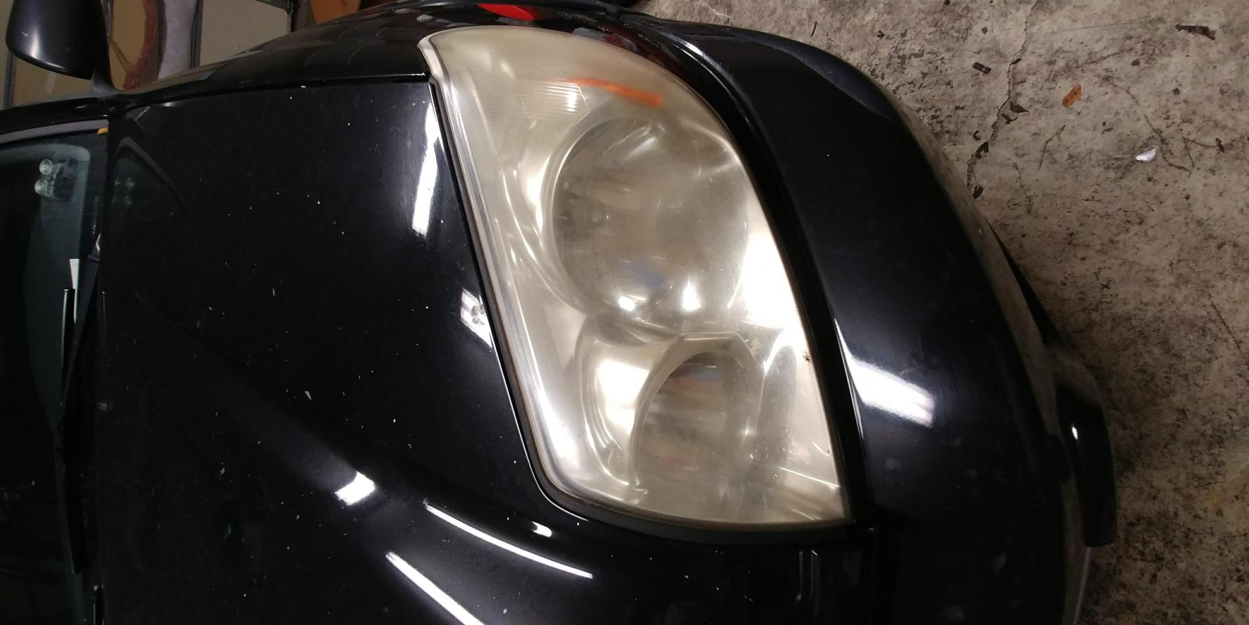

Just replaced mine, not super impressed
I just replaced mine, but the left on isnt draining correctly, not super impressed with it and Im thinking of drilling a hole so it stops fogging over
