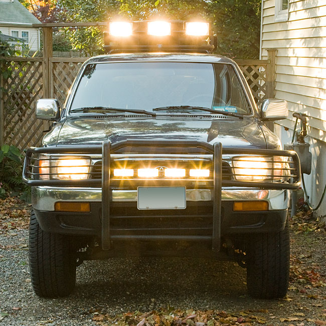

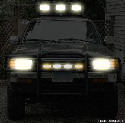

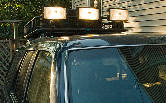

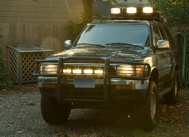

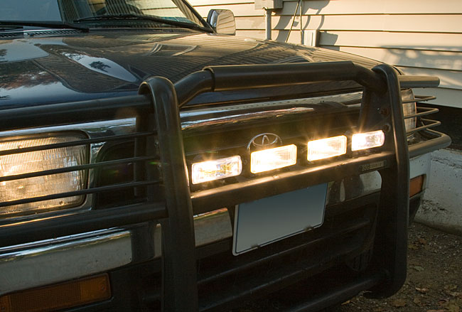

UPDATE: Two of my three sets of aux lights are wired up & working great. The three big lights on my roof are next on my to-do list. Will post pics when done...
A couple of people have asked how I ran the wiring to the roof lights. Short answer is through the third brake light cover. There's already a hole in the roof there, no need to drill another.
