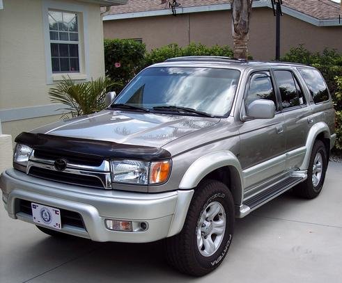

thanks so much, i just completed the DRL disable mod....it was pretty easy. I feel so....empowered now. It's not an every day issue but there have been times I wanted to shut the lights with the car running and it was never possible with the DRL feature. I also feel like I made my 4runner more "old school" without that feature. Although, by now, our generation 4runner is becoming old school even without mods
