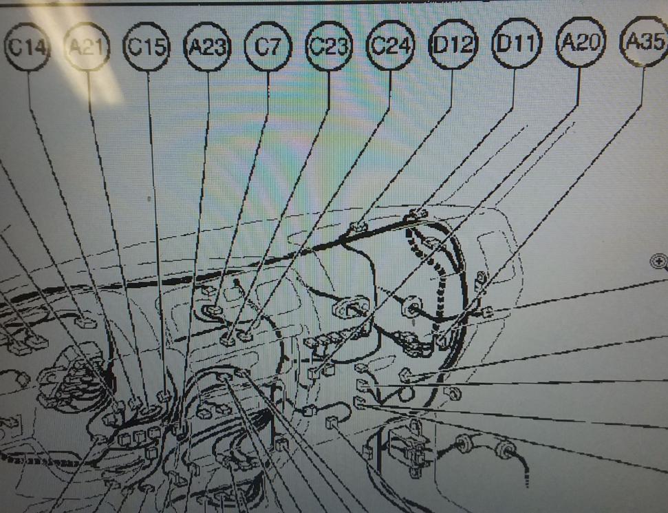

I am not as familiar with the 01-02 but from what i can find on alldata for the 01-02 they are calling it diode (daytime running light NO.1) D12. With that said I have never just unpluged said on a 01-02 to make sure its as simple as the 96-00 that use a resistor... The diode is located up behind the passenger air bag from what the pic shows.
FYI another member on here said it was located under the steering wheel but i have no 1st hand knowledge.
