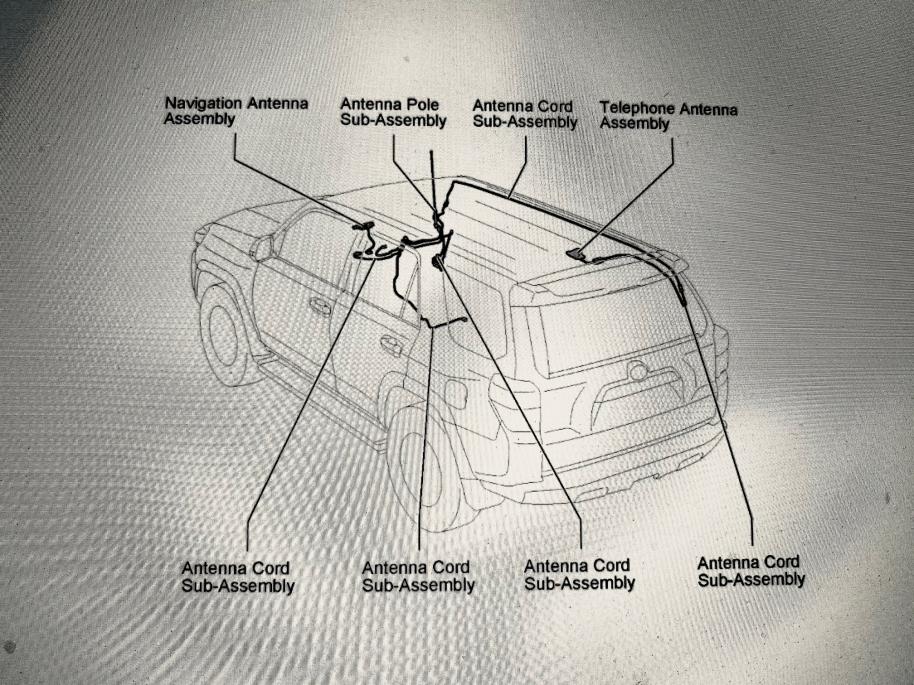

A quick note on #2 - there are two IDENTICAL plugs behind the dash, at least there was behind mine. There is one that comes down independently from the upper dash/behind the clock. I'm now almost positive that is for the compass/navigation, and is NOT Sirius. The plug you'll use is in the factory wire loom w/ other radio connectors, believe it's a black connector IIRC.
I spent over an hour on the phone w Sirius before I realized I was an idiot.....

2013 Antennae
