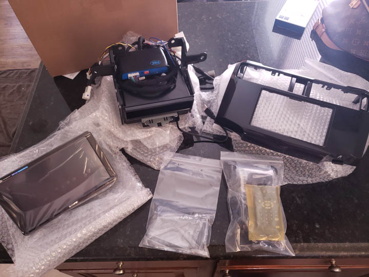

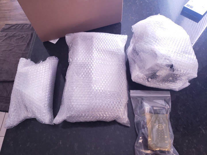

  • Packaging was marginal and my unit arrived with minor damage. While the gouge in the side of the box cannot be blamed on Trail Grid Pro, the damage might have been avoided with more robust packaging.
  • Connections between the PAC harness and Sony harness under the tesa tape were soldered but covered with electrical tape rather than heat shrink tubing. Electrical tape should be entirely adequate in this application, but the harness is advertised as using heat shrink.

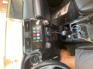

Received package on Friday
Stereo was delivered at 6pm and was installed by 8pm! This thing was super easy to install. I'm not a technical guy but they weren't kidding when they said "plug and play". I didn't really plan for routing the mic or the 2nd USB so i just fished the mic towards the driver footwell and the 2nd usb next to the cabin filter in the glove box. I will work on those this weekend. Unfortunately the stereo doesn't have wireless carplay as someone mentioned earlier but it did come with the latest firmware 1.12. Over all everything works as expected. I'm new to carplay so it will take some time to get used to it. I did get the weblink host app and it works pretty well. I was able to watch YouTube on the unit. I will miss the weather radar app from the old unit but hopefully more apps will be available soon in carplay. No doubt i saved money on this bundle because im the type of guy that would have paid someone to install it for me.
Thanks to Cliff at Trail Grid Pro, he helped me with my order and was also quick to respond to emailed questions (next day)
Next i will be upgrading to some speakers worthy of this unit.
** Update **
- You can turn on the rear camera whenever you want
- You can view YouTube whenever you want (with weblink)
- No luck watching vids on USB- (verified compatible file types but the USB#1 is not recognizing playable data)
- Compass is gone (with factory nav)

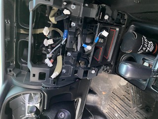

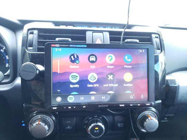

I just wanted to stop by and say I had the same great experience with Trail Grid Pro. Excellent quality in shipping and packaging. Customer service was phenomenal, I had some install questions, and Cliff was responsive and even zoomed called me to walk me through some issues. Got the Sony 8100, floating screen display and am happy with the setup and features.
