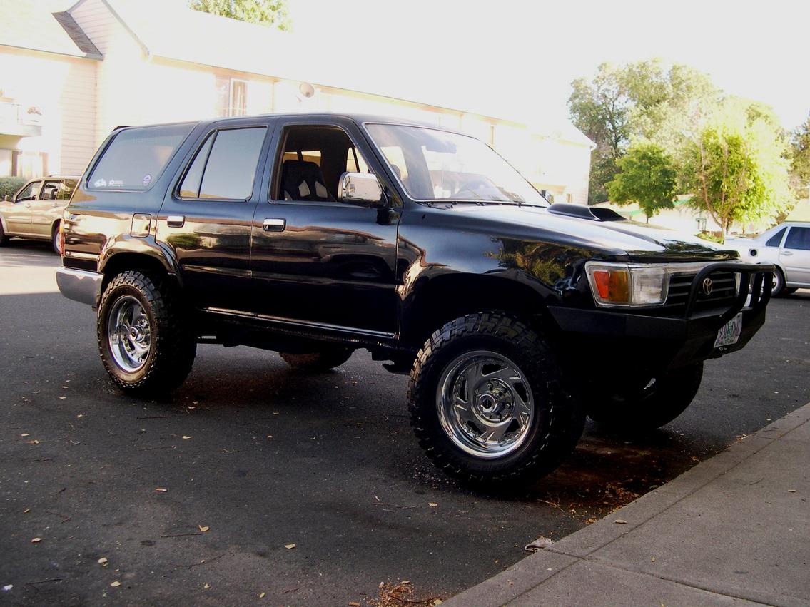

I had heat issues (or what I thought might be) and in knowing that I was going to re-paint the truck, decided to add a scoop to direct air behind the engine and down the tunnel...it worked, with the heat on the inside being barely noticeable now.

I looked at different ways to get cool air under the hood...to do the scoop like the new Celica's...the support structure of the hood needs to be changed to the point of running out of room between the hood and manifold...no good without support, so I did the external type, molded it to the hood (versus stick on like the Honda guys you mentioned) and painted with the rest of the triuck...Fiberglass hood is an option at about 300 and up. Don't know about the cat / heat thing...mines gone, and I've got two coolers, one in the radiator (stock), and from there to an aftermarket one behind the grills in the bumper. No heat problem.
