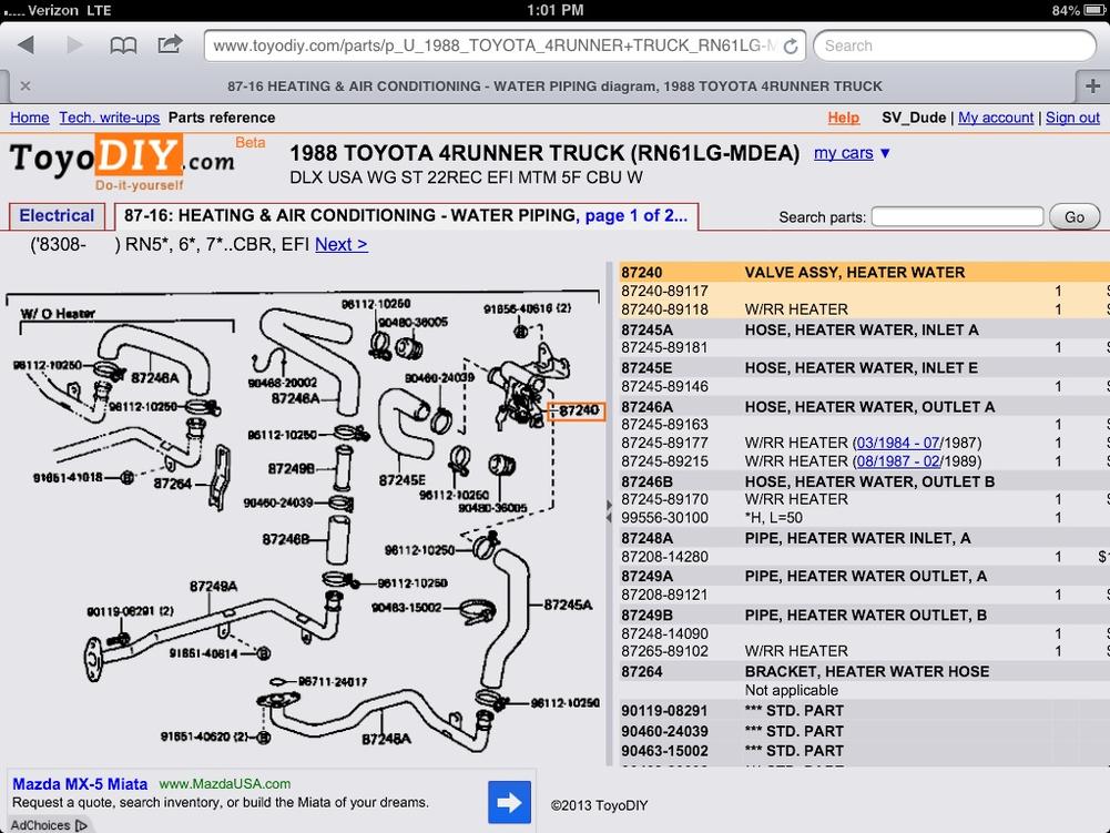

That piece the cable wasn't hooked upto won't budge. Put some wd on it since everything under the hood is covered in varying layers of mud/dirt....still wont budge. What is the damn part or #? Some sort of heater hose check valve or manual temp regulator?

Ed,
I attached a picture from a Toyota parts diagram. It also has the Toyota part number to the right. Hopefully this helps.
