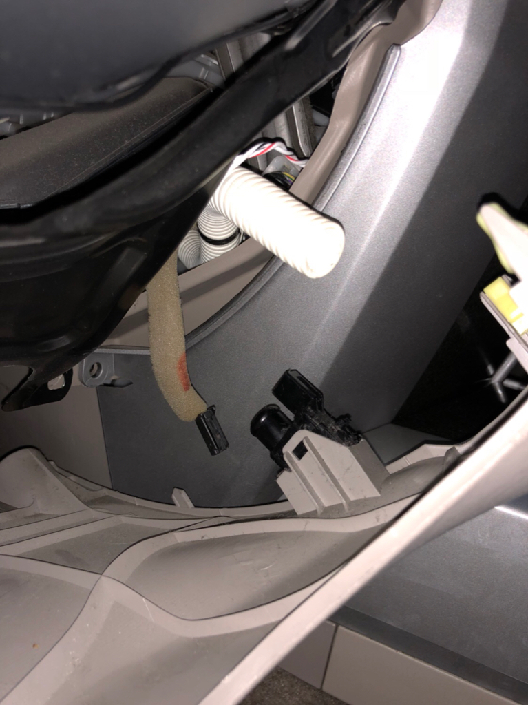

Found another thread where progress4m states the issue may be the temp sensor unplugged.
Took apart the lower portion and found this.
Thanks progress4m [emoji56]
