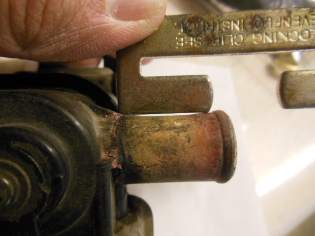

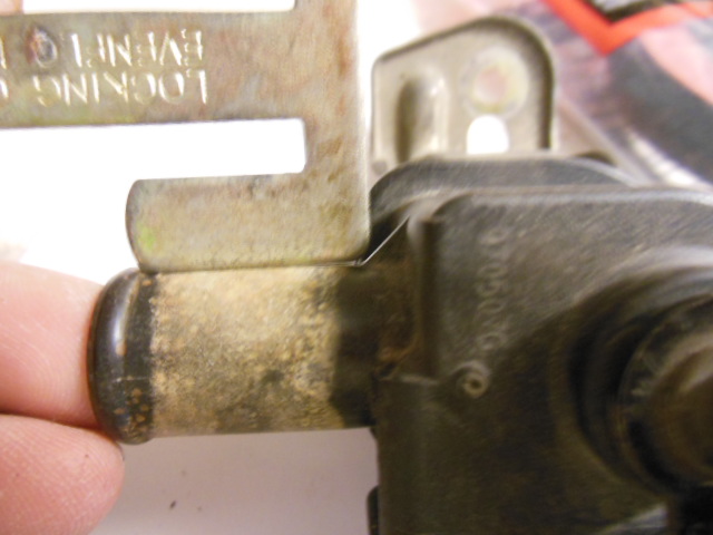

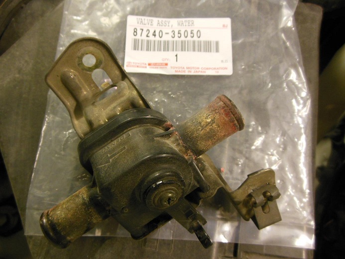

Recently I noticed some crust like material building up around the joint at the heater hose and valve assembly.
The 100 series landcruisers have a failing heater T that just fails due to age.

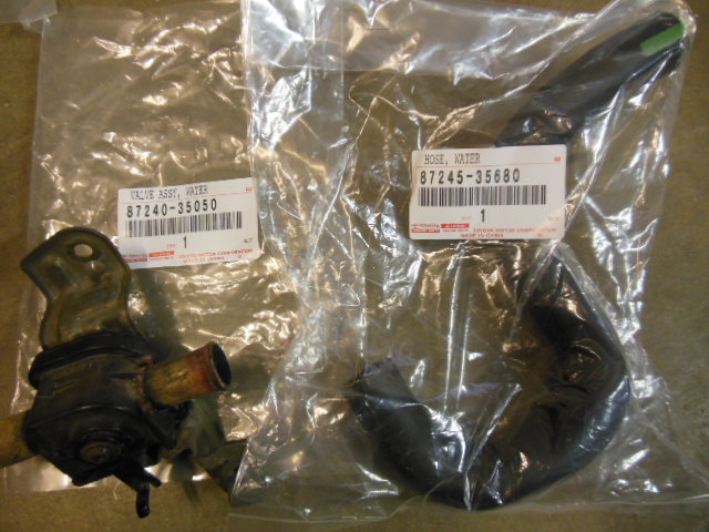

Based on this I decided to replace the heater valve assembly OEM from Amayama.com.
Heater valve assembly: 87240-35050 ($35 + shipping $9)
Heater hose 87245-35680 (didn't replace)
Interestingly, I noticed some wear on the top of the inlet (see picture). No wear on the output side.

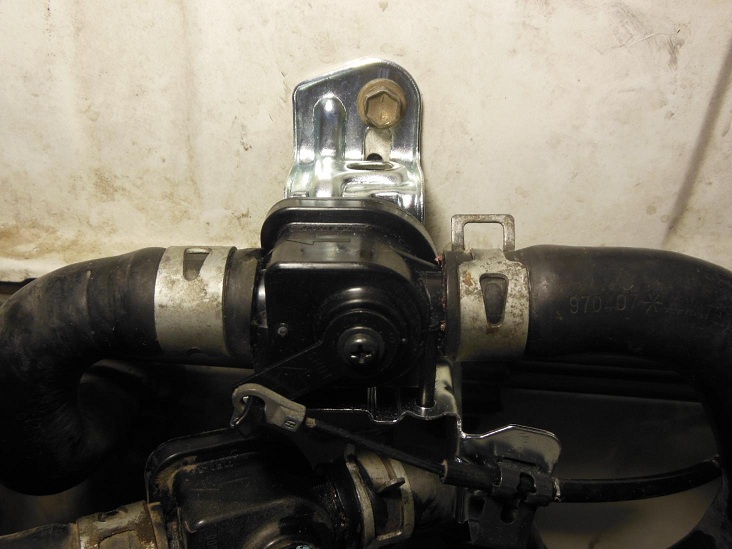

Note: I disconnected the rear heater and removed the "T" joints on both heater lines. I then attached hose (87245-35680) directly on to the valve assembly. It sits at a slight angle and this may have caused this wear.

Why wouldn't the inlet side have more wear? Closing the valve is going to let crud accumulate there compared to the outlet.
You can buy these from Oreillys or whatever. They will work fine.
For all the ones I've seen that's the side that falls apart, the lip crumbles off or the whole thing breaks off. All of them were as originally attached. I didn't think to note wear as you did [MENTION=85046]nissanh[/MENTION] , will have to do that next time, curiosity being what it is.
I went aftermarket with the first one....won't be doing that again. The price difference doesn't math out in the positive when it fails so quickly.
I used a 4 seasons heater control valve. NOT impressed with its quality. We'll see how long it lasts, there's always a couple of hose couplers in the tool box if trouble shows its ugly face.
The 21 year old Toyota heater control valve is still in decent shape except the lip on the left hose nipple is gone. Missing. No more. The part that's left looks a little crumbly, hopefully the bit that disappeared doesn't become an issue. Explains the minor coolant leak there.
