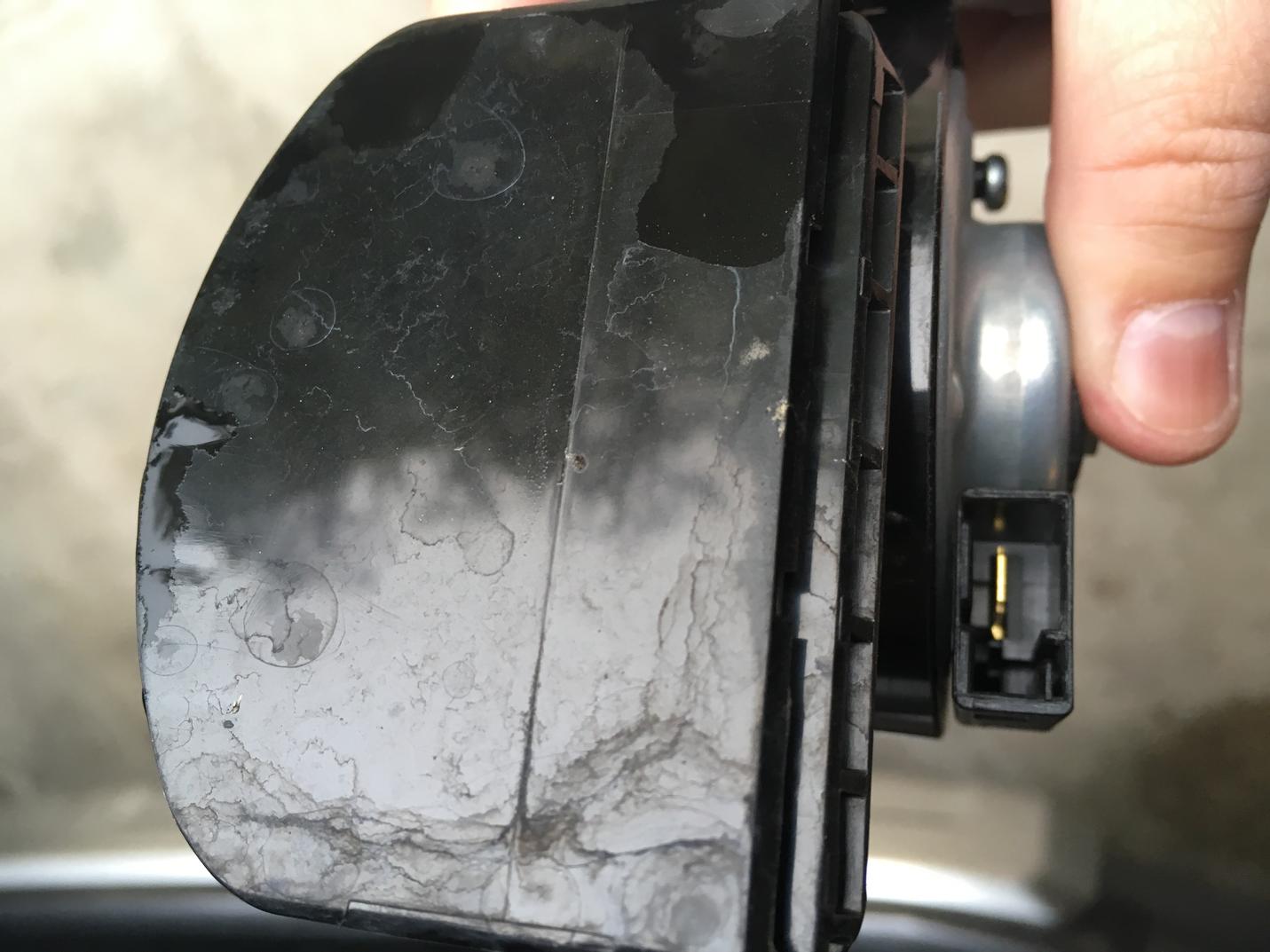

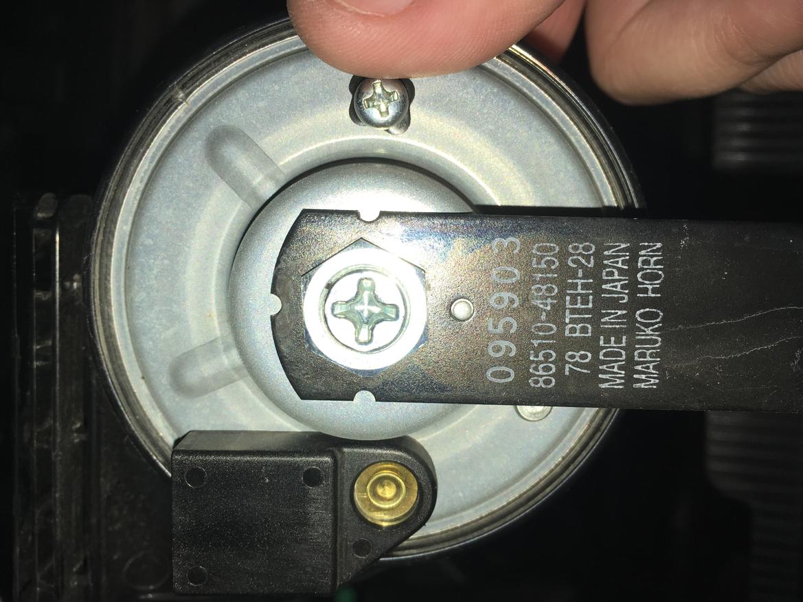

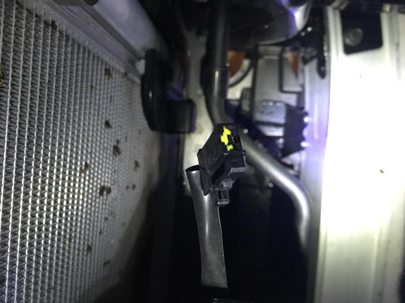

Not to bring up an old thread, but has anyone figured out how to replace the stock horns with the male/female snap harness that jawkdna was talking about? I've got a 2017 Magnetic Grey TRD Off-Road. I noticed the stock horns are better than they have been for the other 5th gens, but they are just not loud enough for the idiots in the suburbs. With the snap plug, is it also plug-n-play? was thinking about getting some hella sharptones. I did check, and there are two horns in the engine compartment. Looks like they have some sort of plastic weatherproofing at the bottom, which might be causing them to be muffled. I've attached some images.

yes its still plug and play. I replaced my horns on my 17 Pro with the Hella Supertones. The wire still plugs into the Hella horns, it may not snap into them but does plug in. Then just create a ground for both horns and they should work.
