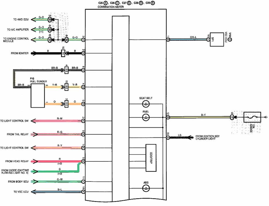

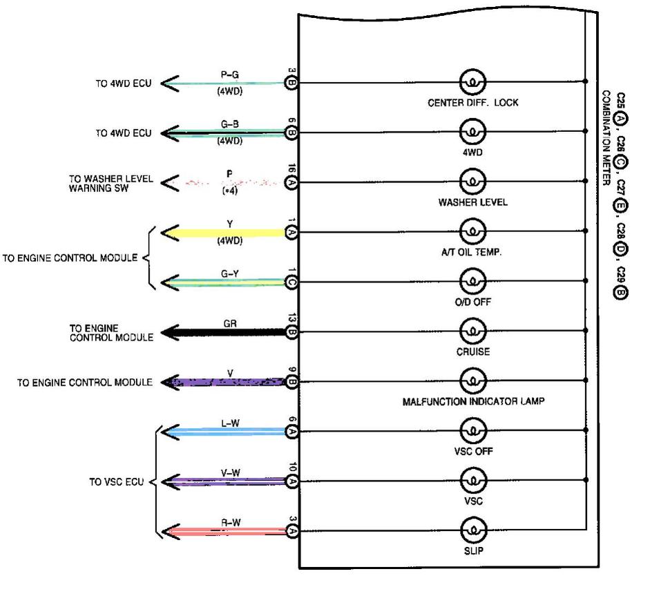

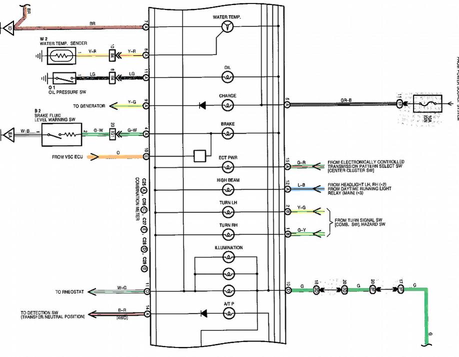

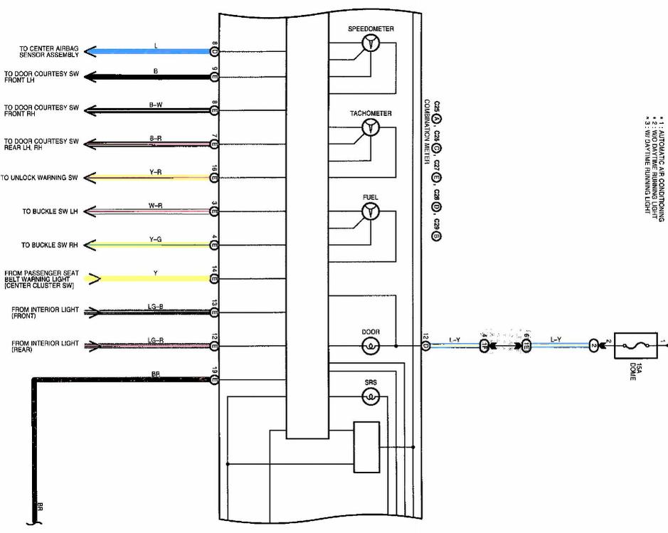

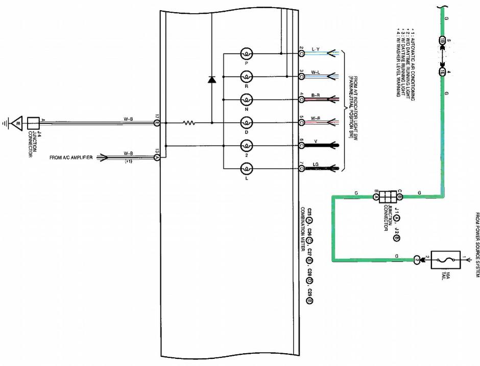

I was able to resolve the shift lock and window situation. I'm down to the lights on in drive situation. I have narrowed it down to the "gauge" circuit, I pulled the "gauge" fuse in the fuse box inside the car and the lights shut off. There is also a weird hum coming from behind the gauge cluster. I'm going to pull the cluster and see whats going on behind there.
It looks like the turn switch is part of the gauge circuit, it is possible that switch is bad and back feeding through the cluster. Bad turn switches can do some weird things. Here are some wiring diagrams for that circuit if it helps.
