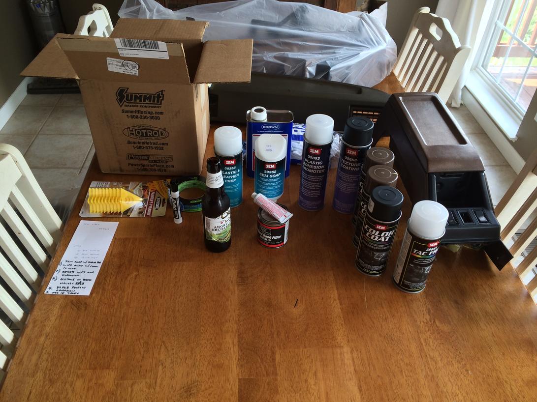

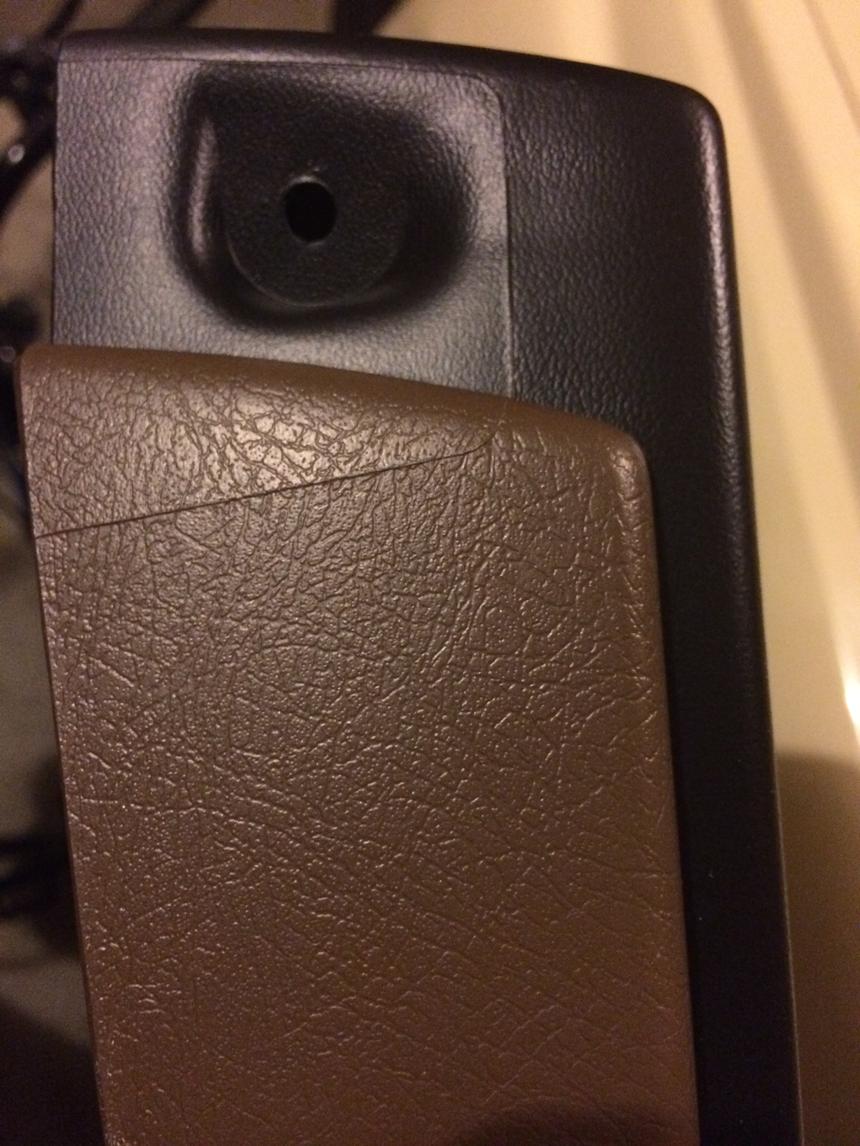

I am just wrapping up a re-color of my interior and plan on doing a better write up when complete. I HIGHLY recommend SEM coatings. I cannot tell you how impressive the finish is if done correctly. The third image here is of a 29 year old shifter trim piece completed. My 85 came from AZ and the interior pieces were very rough. It's absolutely fair to say that I could put them in front of anyone and they would think they are new now. Time consuming... yep, but I somehow found myself enjoying it.

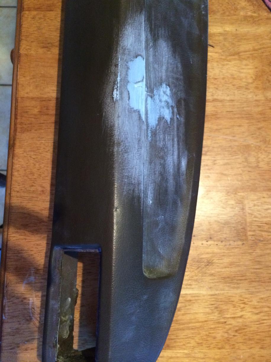

My dash had a couple cracks in it as well and you can easily fill with dash filler, re-texture and paint it back. I had a brown interior and can say that "Bluebird Brown" is almost a direct match... not sure about the grey.
Follow each step of the recommended process. I used the SEM Soap, adhesion promotor, prep spray and color coat. My pics are large so you can see some of the item #'s. You do not need the satin clear coat and in fact, my can was bad and spayed inconsistently so I didn't use it at all. For the entire interior, I only used (3) cans of Color coast and (1) of the other products. I ordered everything from Summit Racing and did not spend a lot actually on it. More pricey was the carpet and seat upholstery.
