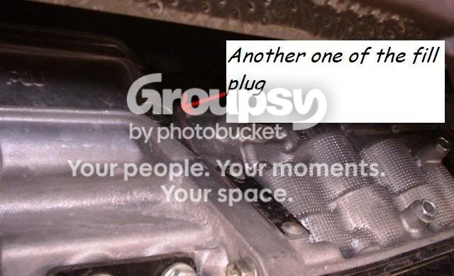

By mistake i drained about 2 pints of trans fluid out when changing the engine oil. Any one know where the fill plug is?
I have looked at other posts for 2 hrs and none look like what i have. I have the WS fluid to replace just can't find the plug.

Thanks for the link, but i've already read with no help. The pic of the fill plug is not the same as mine. I have no fill plug on the side. Maybe on top, but i can't find it.
It's there... You're going under the vehicle from the passenger side?
The exhaust may be a bit different on your V8. This is from my V6...

My trans is as clean as that one in the pic, and there is NO plug at that location. Mine is a V6 also. Maybe the year model makes a diff.

Look at the pic on land cruiser owners on line. Are there two differt auto 5 speed transmissions? Looks that way.
He's got the V6, is the Land Cruiser V8 transmission the same?
