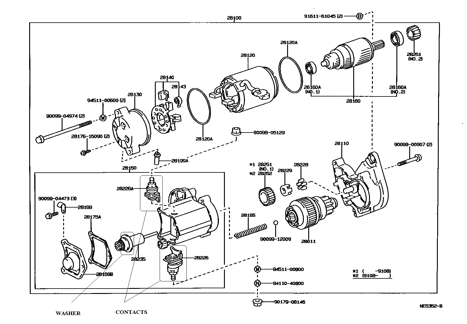

ok well its started every time now since i posted this.....but then it decided not to when i went to leave work. luckly my fiance was still awake so she came a got me. also looked in the toyota epc and theres no "contacts" listed just brushes for the starter and a brush holder.
heres what i found so far
http://http://www.toyotapartszone.com/online/Page_Product/PartDetail.aspx?model=4RUNNER,TRUCK&year=1989&catalogCode=671450&VAID=3521&selectConditions=(10=USA;1=3VZE;3=2D;5=ATM)&subModel=JPP-4%20WHEEL%20DRIVE&sectionID=1&componentsID=19-04&componentsIndex=26&pictureName=NE5352B&ZoomGrade=3&XScroll=79&YScroll=440&isBigPicture=False&isDisplayAll=True&isAdd=false
idk so im taking the car out tommorrow and gonna take a hammer with me and see if i can get it started to bring it home. look at my link and tell me what you think i should order.
NE5352Bmod.gif~original
Buy the kits.

Well I went to the dealer earlier today and ordered new contacts and a new plunger hopefully they will come in saturday. On a side note I did see a brand new t4r on the lot sweet truck
My neighbor insisted on rebuilding my starter again so aftter I got the new plunger and the starter contacts I pulled it out again and droprd it off to him last night and got it back tonight. He bench tested it 8 times and it pased everytime today. He even threw in a new nut for the power cable! I will install tommorow after work and let you guys know how it goes over the next few days. Thanks to all of you
