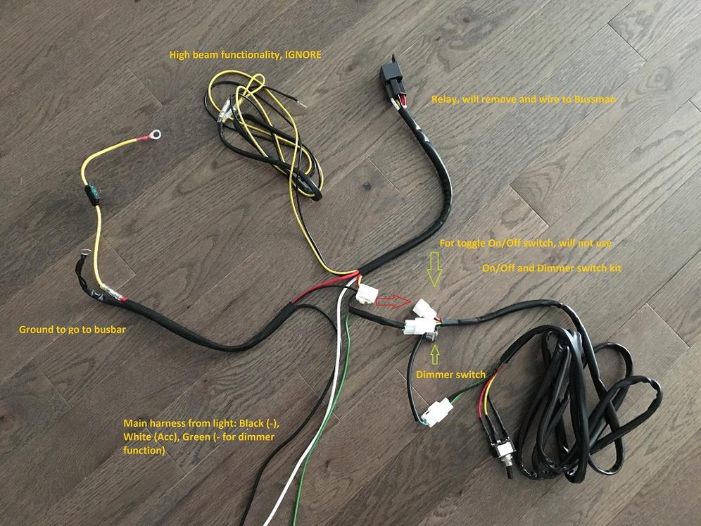

All you smart electricians out there! So I'm trying to figure out how to wire the dimmer/strobe wire on my BD light bar to an AOB switch (mostly wondering if it's possible).
There's a lot of extra shit on the main harness I won't use. Suffice it to say, black to negative busbar, white to the Bussman relay on 87, and then 86 from Bussman will go to the AOB switch for basic power On/Off to the light bar.
My question is - how do I wire up the (-) green wire which serves as the dimmer/strobe wire to an AOB switch given that it's part of the main harness coming straight from the light?
Thanks for any and all help in advance!
