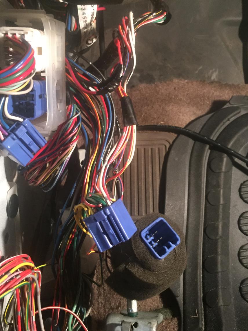

image.jpgHey automan can u hold down the button on the romeve to the point that the alarm goes off can yours do that if u hold the button down till the alarm goes off??? If it does trigger the alarm by holding the top button of the remove i might end it knowing whats your problem. If u get the lower cover off and the side panel where the rs3000 harness is located at u gona see a blue connector which is the one that make the power doors work and around that u might see 2 more blue connectors that are in a loop connected to eachother and if u see that just unplug those 2 blue connectors and those 2 connectors are from the rs3000 harness and u need to plug one end of those 2 blue plugs to the harness of the vehicle and the plug from the harness of the vehicle goes to the rs3000 harness. Here is a pic of what im talking about. Hope this work for you.

And something else i just read your post you mention you had a grey remot control for your rs3000 and i have a grey two botton remot control that does not work on the rs3000 that i have and my rig is a 98 as well so what i understand is that you need to have a black remote control in order to make the alarm work. I got me one from autozone is like $90 bucks and with that one i program it in a few secs i had it to work so you might want to check that out too
