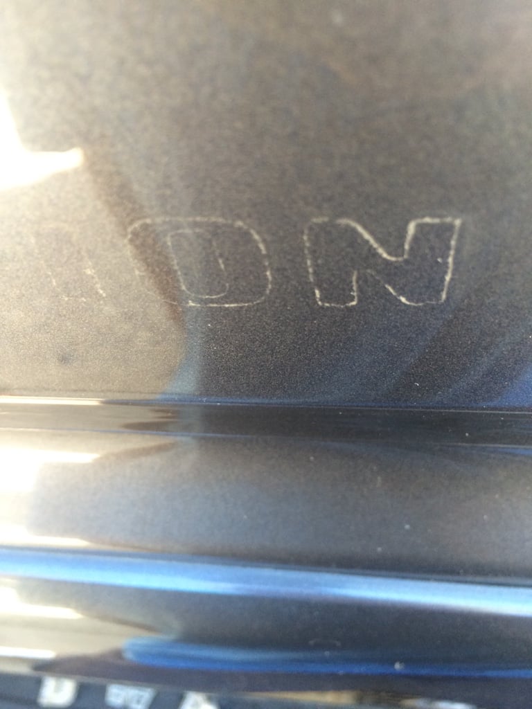

I began to debadge my car the other day and started by removing the SportEdition4WD badging located on the drivers door. After using some floss, a heat gun, and some WD-40 I was able to remove the badging along with the thick adhesive, however, there is still some glue stuck on the paint outlining the letters that won't come off. I tried Goo-Gone, Goof Off, and some other cleaners which did not make a difference. Then ordered some 3M adhesive remover from Amazon, which still won't do the trick.
If anyone has had this problem and found a solution or has any ideas please let me know.

OP, try a clay bar you would use for waxing your car. There's usually 3 types (soft, medium and firm). Heat the area well, apply some soapy water and use the clay bar on the area.

wax or rubbing compound might be the best way, since you've tried everything else. I don't think paint thinner will do it. the other chemicals you've tried are very similar to paint thinner. you may have the best luck with buffing compound but unfortunately the emblem tape probably itched into the clear and you will always be able to see where the emblems used to be.
I'm thinking the same as 4gin... Something semi-abrasive might do the trick. Meguiars ScratchX is my go to product. Followed by a coat of wax.
You can try a clay bar. I have used it with great success to remove overspray. I also have used lighter fluid or gasoline with the clay bar.
It's not left over from the tape and those outlines won't come off. It's from years of sand, dirt, tiny pebbles that get trapped in between the emblems and the paint. Overtime they slowly start eating away the finish and now we have this.

Honestly when I encountered that issue I used a hair dryer (heat gun), my thumb nail, and patience. Patience being the key, I noticed when I got impatient I ended up scratching the paint, or putting a tiny fingernail dent in the paint since it was warm.
My finger got hot under the hair dryer so I'd heat it, put the hair dryer down, scrape a bit with the nail, and do it again.
