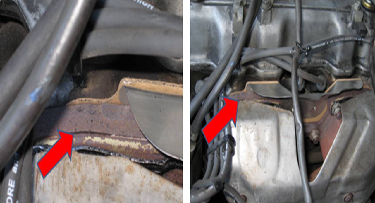

one more question - gasket leak
Hey guys...so the truck runs now.
And the gasket seems to leak a little.
There are metal tabs (about 1"x3") that were with the old gasket and covered up the 4 air holes on the header. there were 2 of them (1 set per pair of cylinders) and they each had residue from an old gasket sealer of some sort it seems.... Check out the photo attached that I just took - showing the leakage area.
Question is...what can I use to seal it up and is it normal to do so? Did i just do a really bad job of scraping off the old gasket maker that was there?
I don't think it's dire straits but I want to be sure and not risk cracking a valve or something...
Thanks
OK, I feel pretty embarassed about this now....I figured it out.
The dark thin things you see in the images I posted - between the spacer plate and the nuts....that's supposed to go on the OTHER side of the spacer plate - between it and the header - that's what plugs up the leaks I noticed, and that's what was all "gunked up" from the previous gasket - was just a different material.
So, after smacking myself, I moved the seals around, tightened it up again and it's running like a charm.
*sigh*
