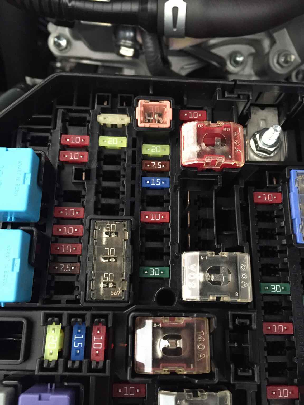

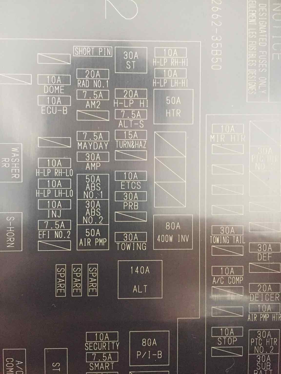

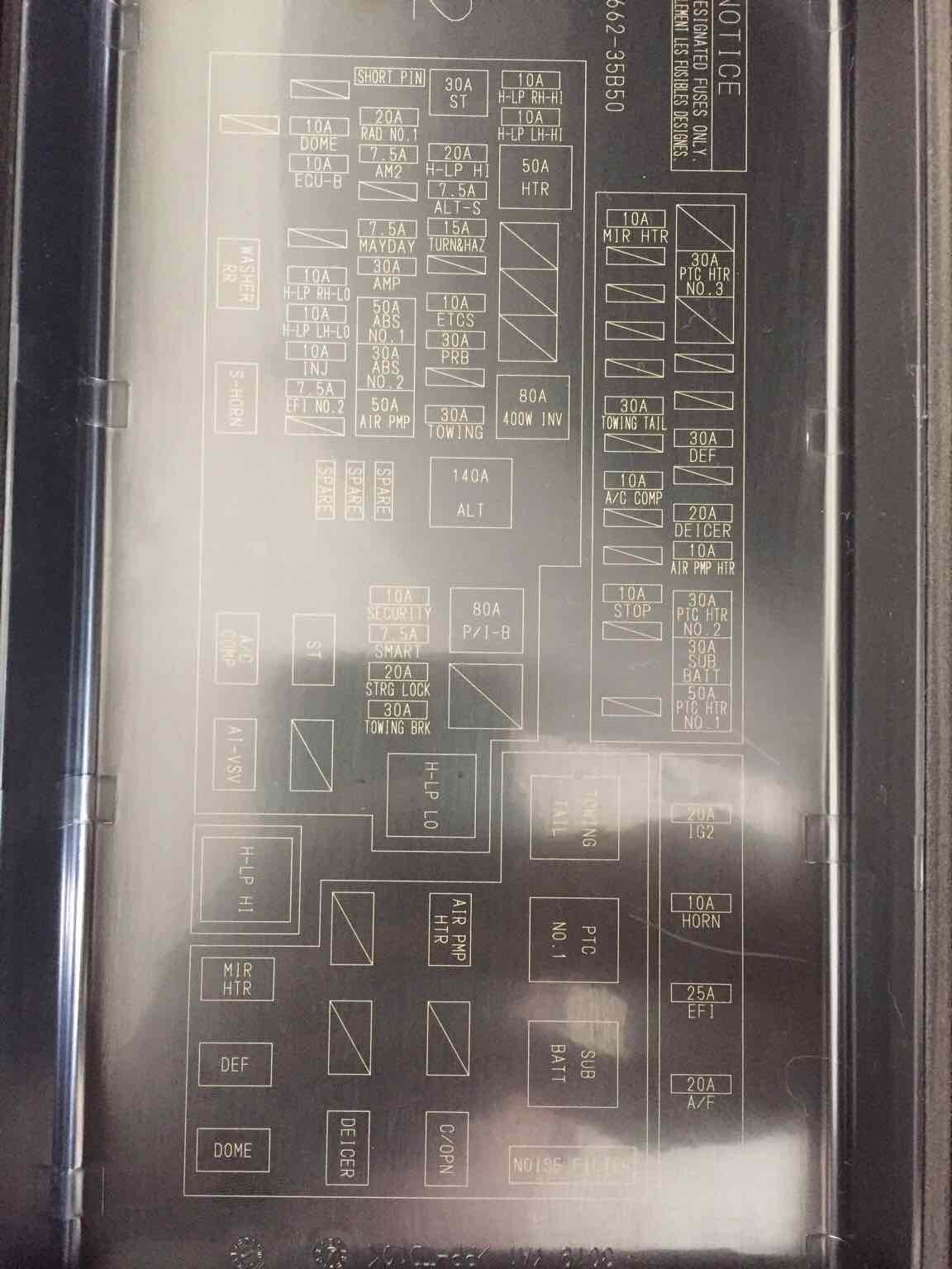

I'am looking in the fuse box now and the only 15A fuse is this one and it's not blown IMG_0594.JPGIMG_0595.JPG
Okay... Now check the OEM foglight harness that plugs into the ballast; you'll probably find power there... "you can just reinstall the stock bulb into that socket to test that"! You most likely lost your ballast... I keep a couple of spare HID bulbs and ballasts in my truck just in case I lose one at night!

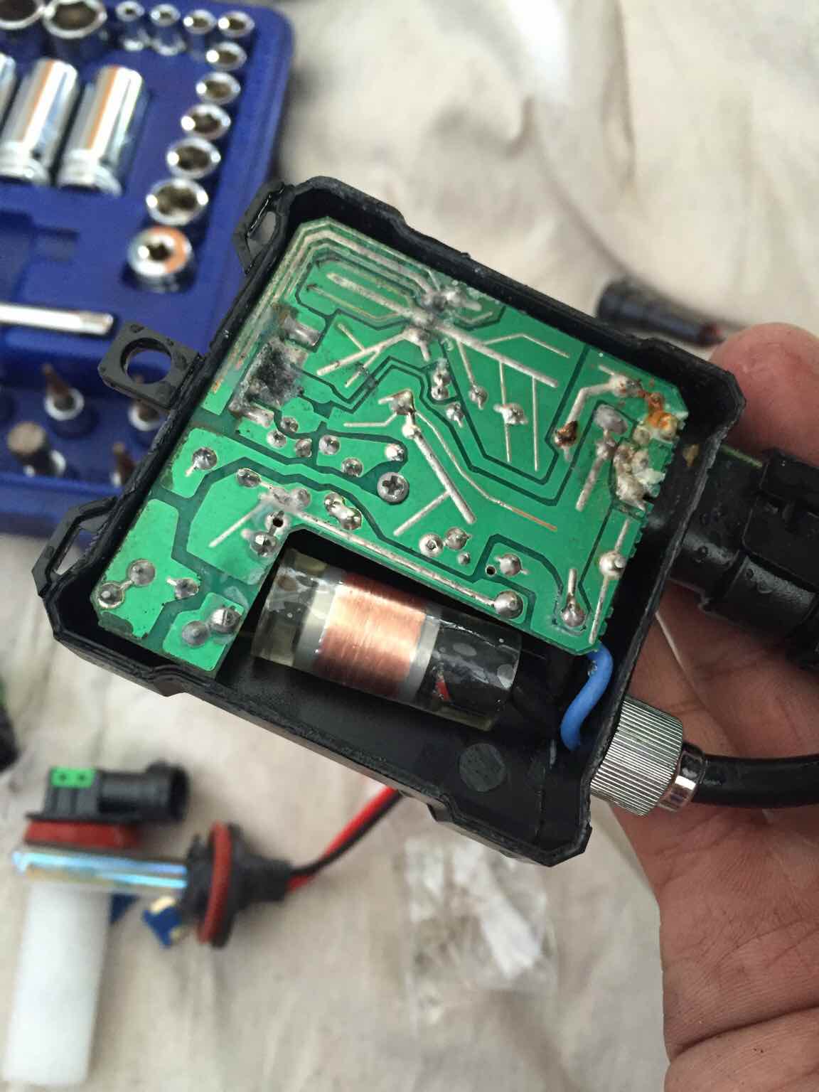

Found the fuse box d/s and it did blow the 15A fuse
That fuse was just doing it's job! I'm using the OPT7 HID lowbeam kit. They're built very well and only set me back $33 bucks; that's why I can keep a set in the rear cargo area as "Truck stock"! They've been in for about seven months and no electrical issues! Here's a shot of the product:
