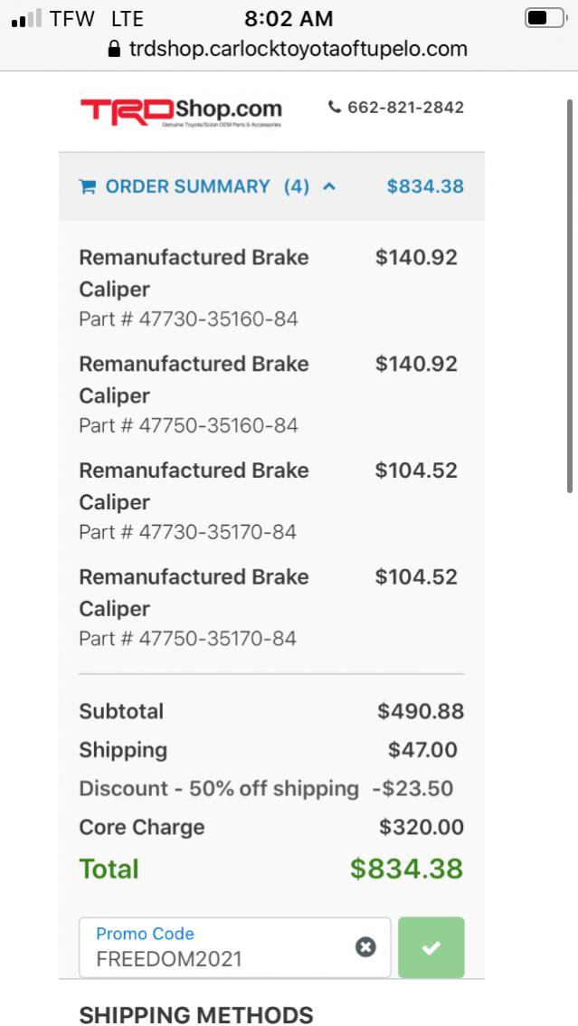

Forget about getting it rebuilt. I found a great deal from TRD Shop in Mississippi. It’s better and more affordable. They use oem seals. These are Toyota remanufactured calipers that you find at the dealership. It cost less than those cheap Centric rebuilt calipers with their made in China seals. The only thing Centric is good at are their cryo treated high carbon brake rotors...I feel that is their only competitive advantage.
