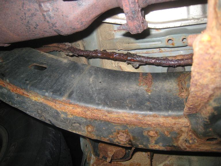

So I need help identifying some solid lines that have rotted away and are leaking. Some of the fluid dripped down into my mouth and it was sweet. If I remember what I have read here correctly, this is coolant? I know there are probably a million posts about this, but could someone point me to the fix as I need to fix this right away.
The tire in the pic is the front passenger. If you have a part number, that would be great too. I might just go to the dealership tomorrow if it isn't too expensive.

Those are the coolant lines to the rear heater. cut away until they are good, and then replace with rubber line.
Option 1: Put a rubber hose around the two coolant lines in the engine bay bypassing those lines. You will lose the rear heater if you do this.
Option 2: Get new coolant lines from the dealer at around 90-100. (I cant remember exactly)
Don't go to the stealership as it cost me $530 to replace the lines. I think parts alone were under $200

Yeah, so today I got some 1/4 in fuel line, cut off the hard lines in the engine bay, and attached the fuel lines in their place. The rear heater was working, so it looks like this fixed it. I will take some pics tomorrow.
I had to cut the 3/8 in line coming directly off the rear heater as I couldn't get the 1/4 in hard line off, so I ended up having to use a couple brass fitting from Home depot to make a reducer from the 3/8 to the 1/4. With some teflon tape it is snug as a bug and doesn't appear to be leaking. I ended up putting about 3/4 gallon of fluid into the radiator and reservoir.

DO THIS ASAP, before you run out of coolant, you may overheat if you wait too long.
As soon as I found this I fixed it. Unfortunately all the coolant had already leaked out, so I don't know how long I was driving it without coolant. I glance at the temp gauge and it has always been right in the middle, so maybe I just got lucky there.
