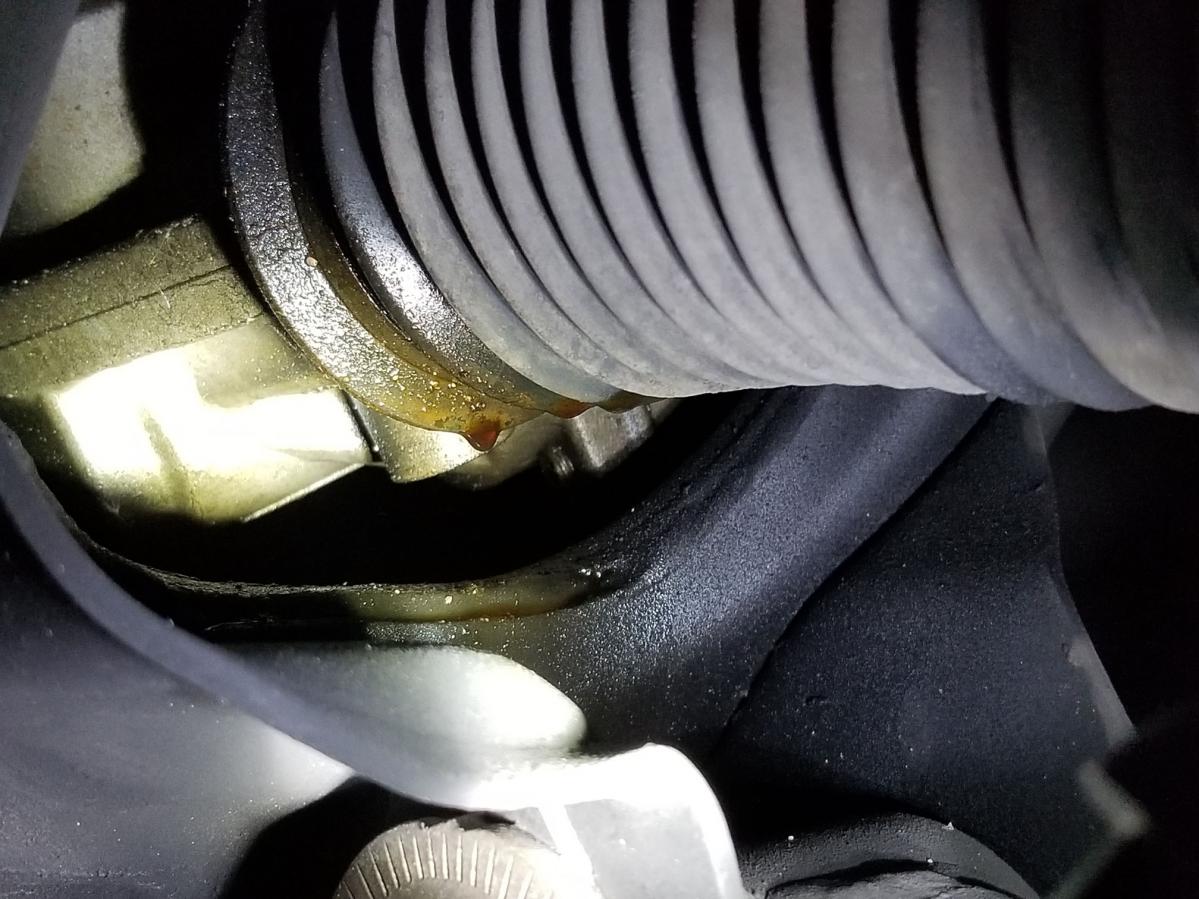

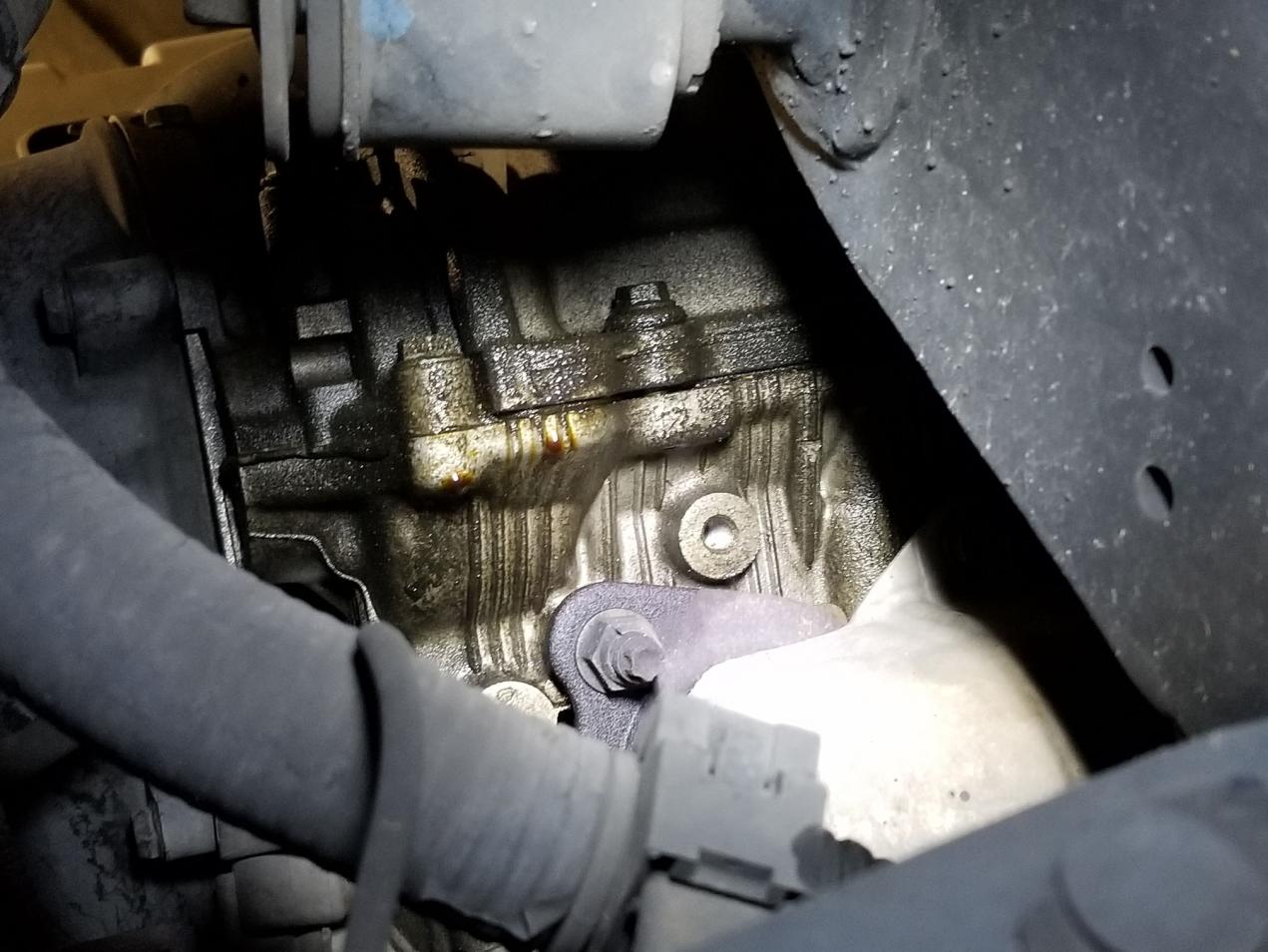

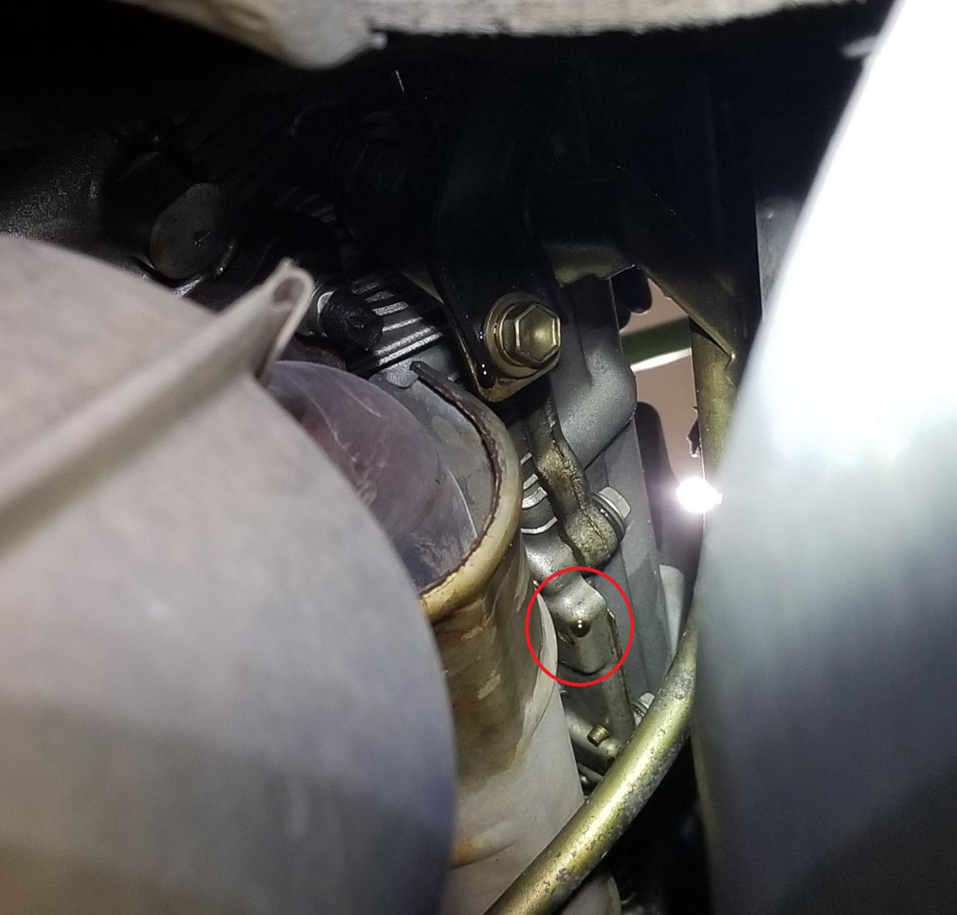

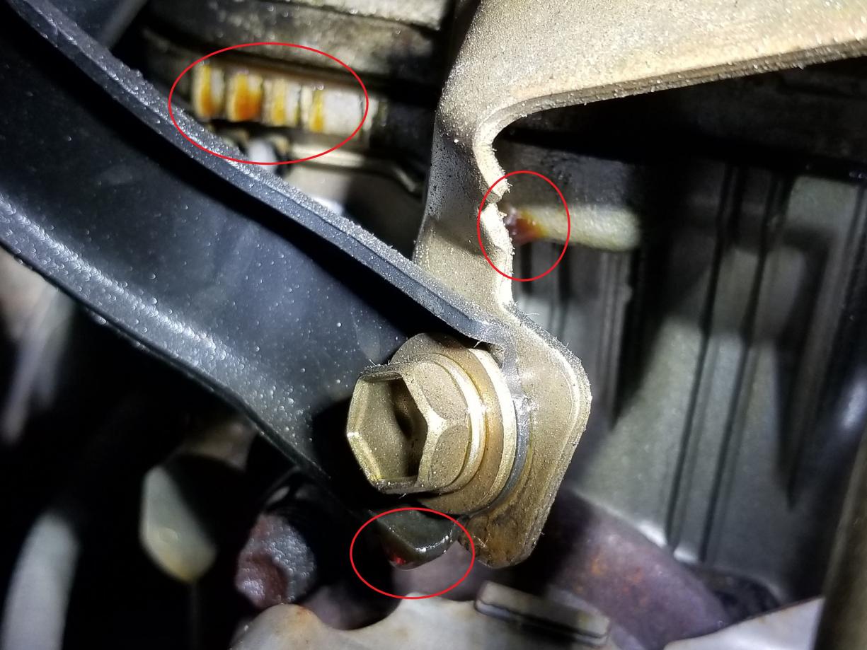

My 2003 V8 started smelling bad in the engine bay after long trips. There are no fluids leaking on the ground, but I took the skid plates off and noticed some oil leaks on both heads. Can you tell if this is the head cover gasket? Head gasket? There's also a fair amount of fluid on the power steering pump, but to me it looks like oil rather than ATF fluid. Thanks for any help or tips to identify the source.

This is interesting. The smell (and I assume oil leaks) started a few weeks after I did my last oil change in Nov which coincidentally is the first time I've ever used full synthetic oil in it. We've all heard about issues with synthetic oil causing leaks, but I read those were debunked. Looking now, those busted myths seem to be on the oil manufacturer's sites. :) Or perhaps I got a mislabeled jug with the wrong weight oil. It's awfully coincidental for both valve covers to be leaking that much and me to have not noticed it before.
I think I'll clean off the leaks and put some dino oil in and see what happens. It's still showing nearly 100% full since Nov. so not much has actually leaked out.
I know I'll be judged harshly, but I used Walmart brand high mileage full synthetic: https://www.walmart.com/ip/Super-Tech-High-Mileage-Syn-5w-30-Qt-Dx/764492025
+1
How often do you have to add oil?
+2
And it's been my experience that if you switch to synthetic on a high mileage engine, you'll never stop all the leaks. I did the same thing on mine at 250k. Oil started leaking from everywhere. I chased leaks for months. I finally switched back to conventional oil and now it's as dry as a bone. You might also check the PVC valve, make sure it's not stuck.
It's been about 3 weeks since I changed my oil back to conventional and wiped off the leaked oil that I could get to, and the smell is mostly gone. It does seem like "High Mileage Synthetic Oil" is NOT SUITABLE for high mileage engines. Thanks for the help!
How many miles do you have on it now?
I wouldn't really consider any Toyota motor under 200k as high mileage. I wouldn't expect any 'high mileage' motor oil to have any benefits in these motors though I don't know how they work exactly.
Heck 'high mileage' is probably closer to 500k with the 2UZ.
High mileage oil is marketed for >75K miles. My '03 V8 has 195K miles on it. I only bought it because it was on sale and as cheap as conventional oil. I expected it could be good for the engine, but I would never have guessed it would be such a bad idea.
Have you checked to see if the valve cover bolts are tight, as in at the proper torque?
I ask this because I always check bolts and nuts for being loose periodically, and also I know that my valve cover bolts were loose when I bought my T4R and it had signs of slightly leaking at the valve covers, after thighening them no more signs of any leaking, I also use a synthentic oil since I bought it and the oil that was in it was not, and I changed my oil at around 6000 to 7500 miles and it's has always been on full when I do change the oil.
