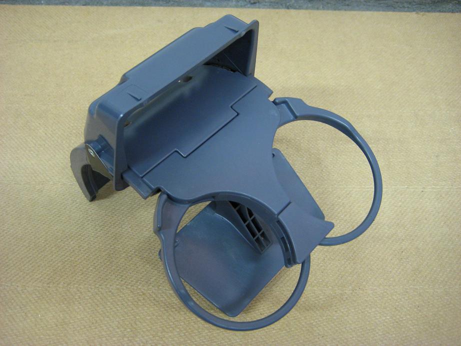

Looking for some info to install a rear cup holder for my 2000 SR5. When I purchased, the cup holder was missing. Found a matching color on ebay for $20. Have'nt tried to remove the center console yet, looking for some tips if anyone has done this. Thanks in advance!

It was pretty simple. I removed the two screws holding the cup holder to the console. Then removed the tab on the rear heating control knob. Pulled away the insert with the temperature setting (it pops right out) and simply applied an upward pressure and the old frame/housing of the cupholder came out. Hope this helps.
