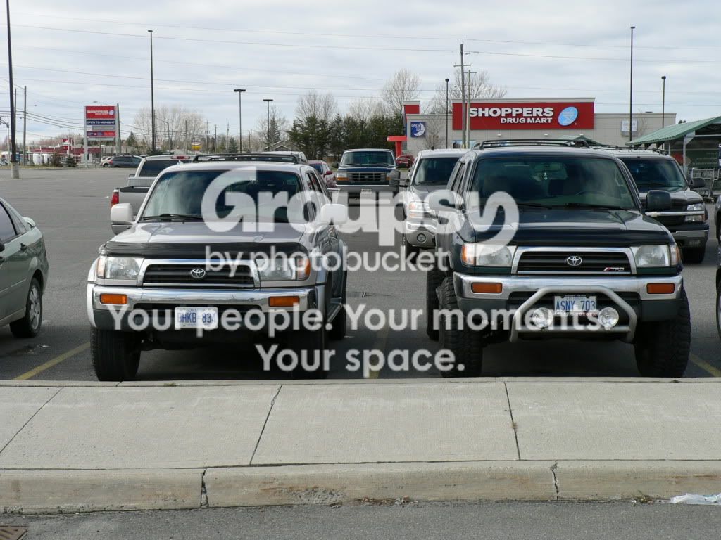

Here's a pic of mine with all parts installed:
While off - roading on a Hydro line trail
P1110360.jpg~original
Mine compared to a Stock 98 Limited
P1110348.jpg~original
Side profile shot
P1110313.jpg~original
I looked toward revtec for the 3" suspension lift and a 3" body lift from trailmaster both for around 500 installed myself to save on labor. I personally would start with the suspension lift and you do need the front diff drop (comes with most kits) or your front half shafts will be useless in a short fun time!
