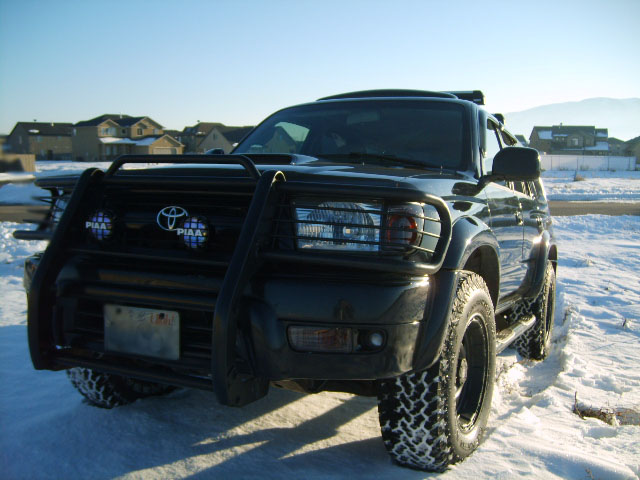

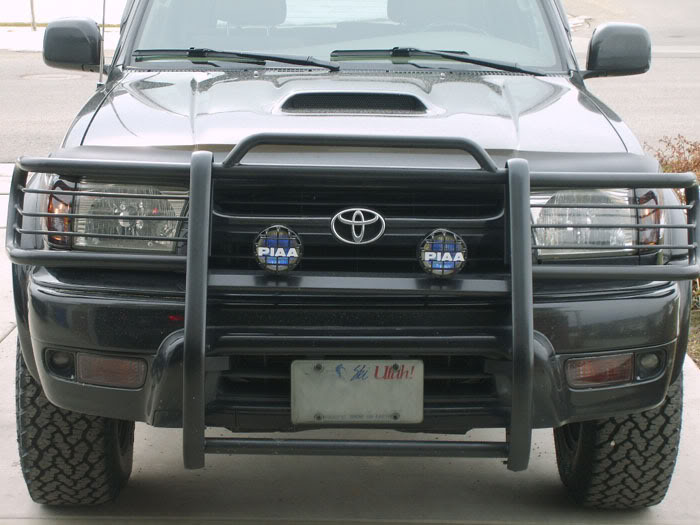

check out laminX man thats what ive used, it's a procedure to apply it but to me it looks tons better than the spray. I don't know if its cause they spayed it on wrong or what but all of the spray that i have seen turns a flat black and it looks like crap to me. maybe im wrong?? here is a pic of my rig with lameneX
I should add light passes through great, it passed inspection and everything, and i have had it on there for almost 2 years now and it still looks good as new.

Thanks guys! sorry i totally spelled it wrong but its lamin-X i guess that matters if your doing a search on google or something but anyway, its hard to remember exactly what i did but i ordered it in a roll and cut my own pieces out. It's like a super thick rubbery tint they have a bunch of different shades, red, yellow, blue, and some diferent balcks. I'm pretty sure i got the smoked color. there is a ton of examples with people doing the different colors. So yeah basicly you have to take the lights out, not hard to do at all, and clean them up, (i polished mine) the just cut a piece out bigger than the lights. Then you gotta spray the light down with a mist of water then start to apply the lamin-x you need to use a blow dryer while puttung it on whike you stretch it over the lights. during this you gotta use the squeegee to get all the bubble's out (kind of like a sticker) but yeah after that just cut the accsess off and your good! it's not that hard it's just time consuming to get it right. The nice thing is it's forgiving and if you do it wrong you just peel it off and apply again. the blinkers were very easy but when it starts to curve it kind of hard. but all in all it's worth it. They give you a cleaning solutition to keep it looking good an honestly i love it!

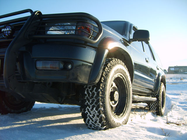

here is a pic with some sun on it

i just found the reciept and i got the gun-smoke roll 24x24 it was plenty with some to spare for future projects. NOTE i only did the front corners and blinkers with only one mistake that i had to re-cut
