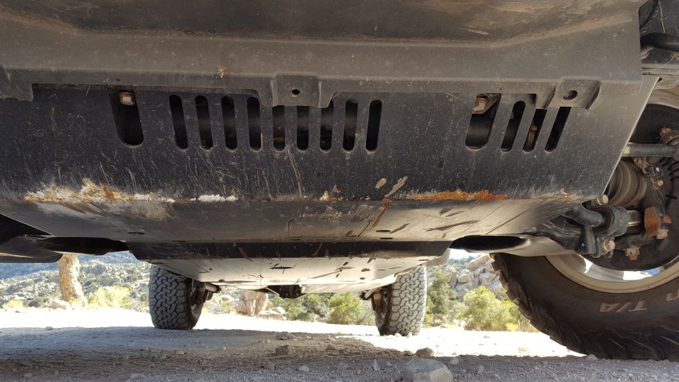

I just installed RCI steel
I got the filler plate, too. I considered aluminum, but I seem to be using my skids....

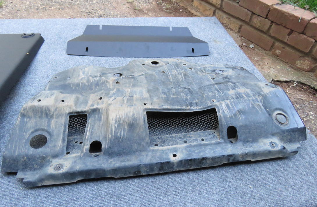

I got steel Bud Built engine and transmission and then aluminum for transfer case and gas tank. Before getting my lift, it was really hard to not smash into things with the low KDSS front end.
Here is my BB front end after a bit of use. Cant see it from this angle, but the steel is bent in at an impact area.
