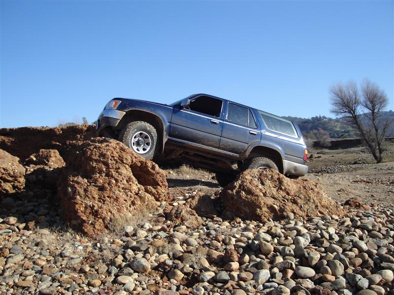

I have a 1993 4Runner 3.0 V6 5-speed 4WD with about 125,000 miles on it. I have had many things fixed on it since I have owned it, but I can
