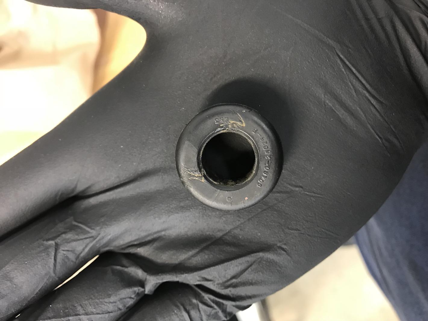

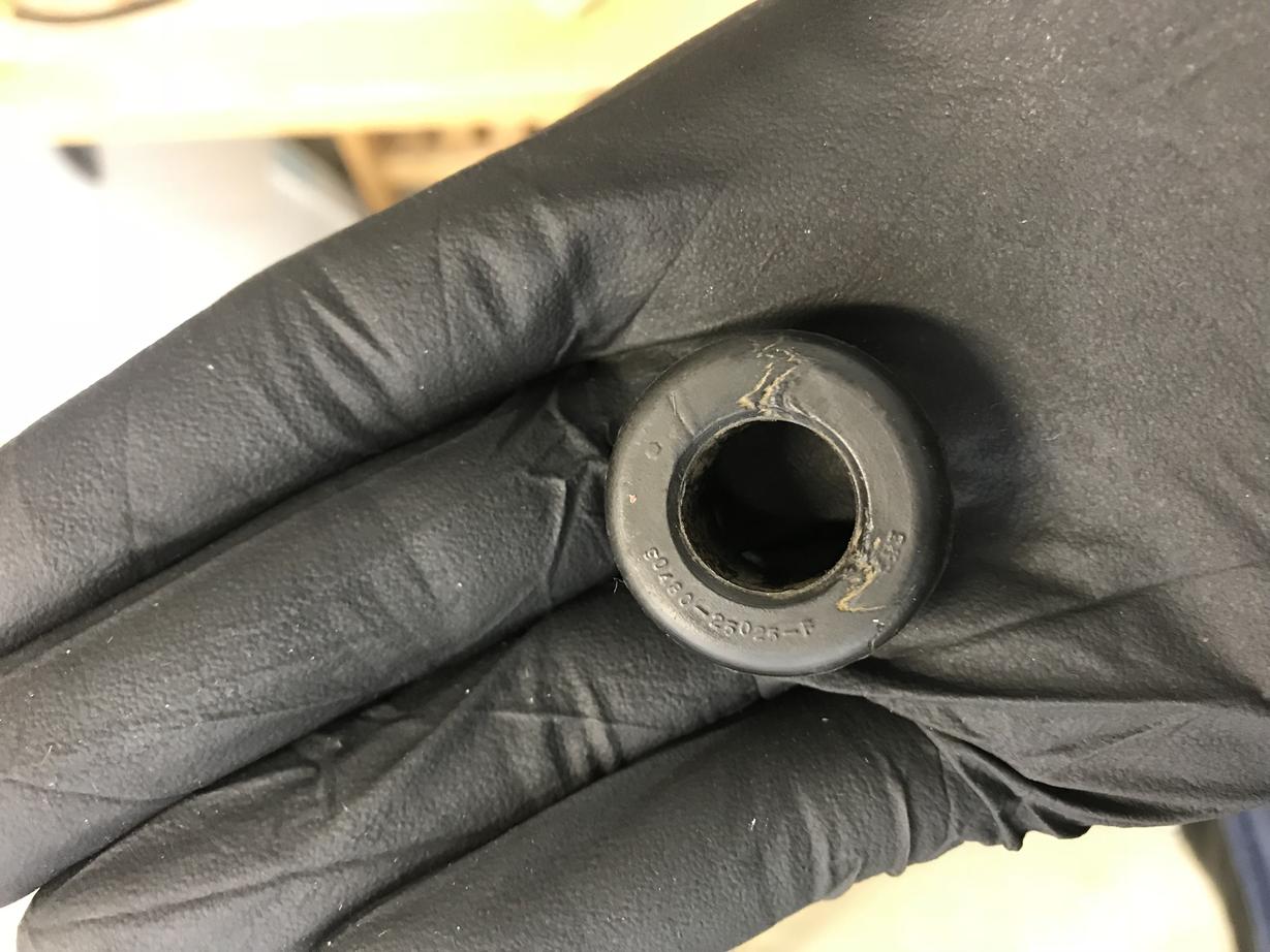

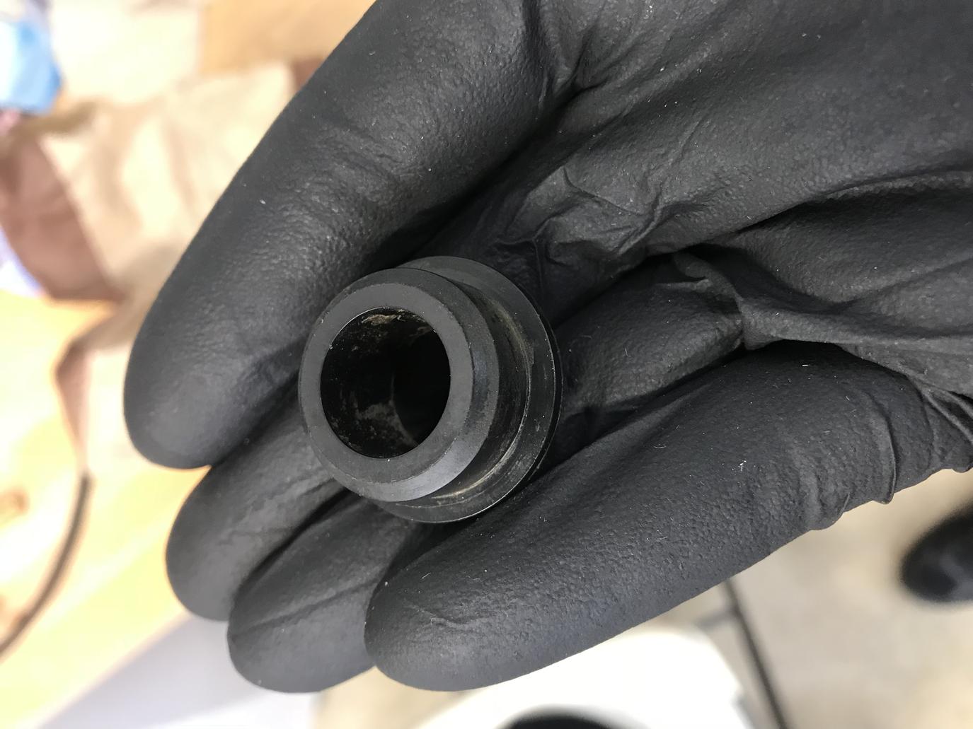

I found this sitting on the engine skid plate after I removed it to change my front diff fluid the other day. I couldn’t figure out from where it dropped.

Looks like just a grommet that was protecting a wire/tube though a penetration. Did you check the firewall just to be safe? This wouldn't just fall off if a tube/wire was in it. I didn't see anything when I looked at the FSM that matched that item.
Lol I posted the exact same question a few months ago. The grommet fits on the nipple on the bottom of the coolant reservoir so it doesn't rattle around/ chaffed against the metal hole it fits into.
Thanks guys. Makes sense since I replaced the reservoir recently. Feel dumb didn’t realize that was the part number, but in my defense I was too busy stripping my front diff fill plug :)
