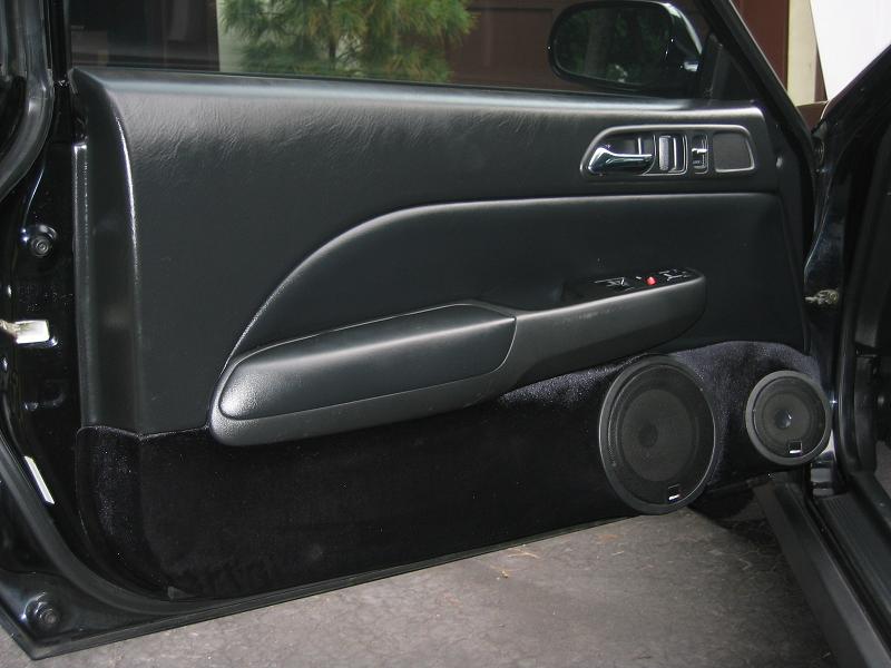

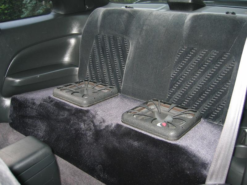

Thanks again DUC! Its amazing how much you lose when you dont use it! I used to compete too...I made it to the IASCA World Finals in 1999, competeing in the 301-600 class! The only thing I realized after doing many show cars...was youhave to ask yourself the main question...is it all worth it in the end? I finished my Prelude like a year ago...and am still tuning it and finidng new ways to get it to sound better...but after doing that car I realized...It's way too many hours spent, and not enough return...With my 4 runner now...i am going the easiest route...one amp...one box!
This was my last big project....

Very clean install. I agree 110%! I was in the 50W and under for a while then the next class up. My 4Runner is going to have lots of power, which I will just turn the gains down for very clean sound, I will tune it with an RTA once, not to flat but to a curve my show car had, and be done with it! I would not go as complicated as I am if I did not have all the gear already. I am even doing the woodworking for the box myself, and cloth/vinyl/fiber glass work make it match the rear panels. I MAY remove the whole right side plastic panel and build it all new so I can build in the box better. I WISH womeon like QForms made kick pannels for these cars!
