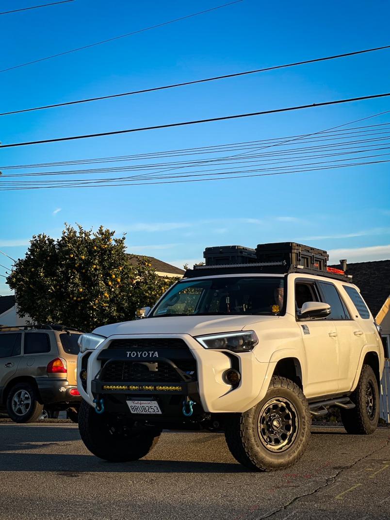

I recently installed an SSO rack and ordered some 95L ROAM rugged cases for roof storage.
I'd like to secure the cases to the rack such that I can open the cases and access their contents without having to remove straps.

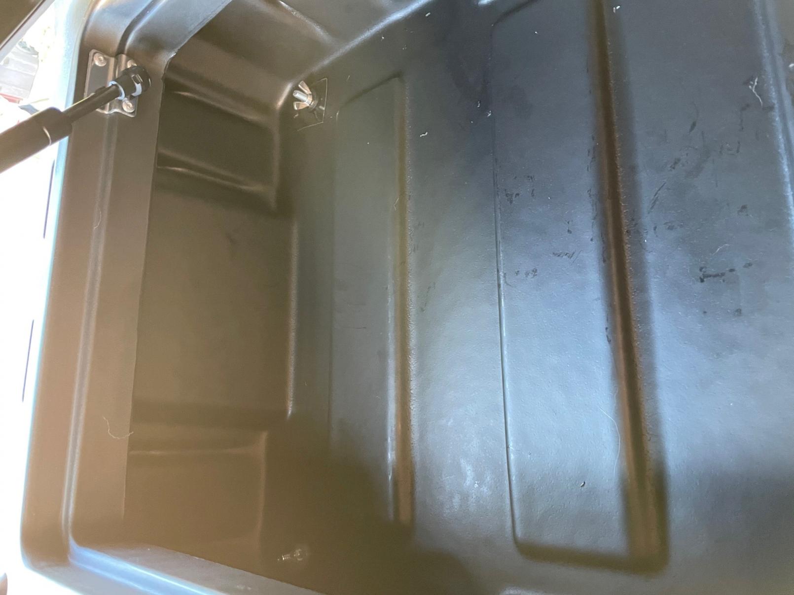

As you'll see from the pictures below, I have a ratchet strap looping through the handle, across the inside of the lid, and through the other handle. This does secure the box to the roof. However, the box has quite a bit of lateral play. I'm not real high on driving on the highway with the boxes moving side to side.

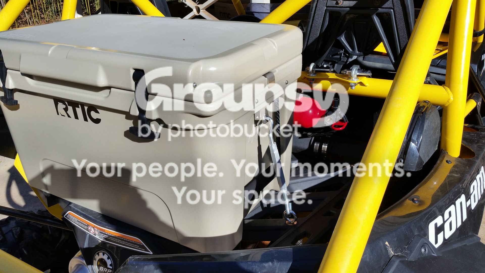

We use turnbuckles to secure coolers in our jeeps. The coolers have similar attachment points, either use a short piece of strap or fabricate a metal L bracket. I have never seen a cooler come loose secured in this fashion even in a rollover.
