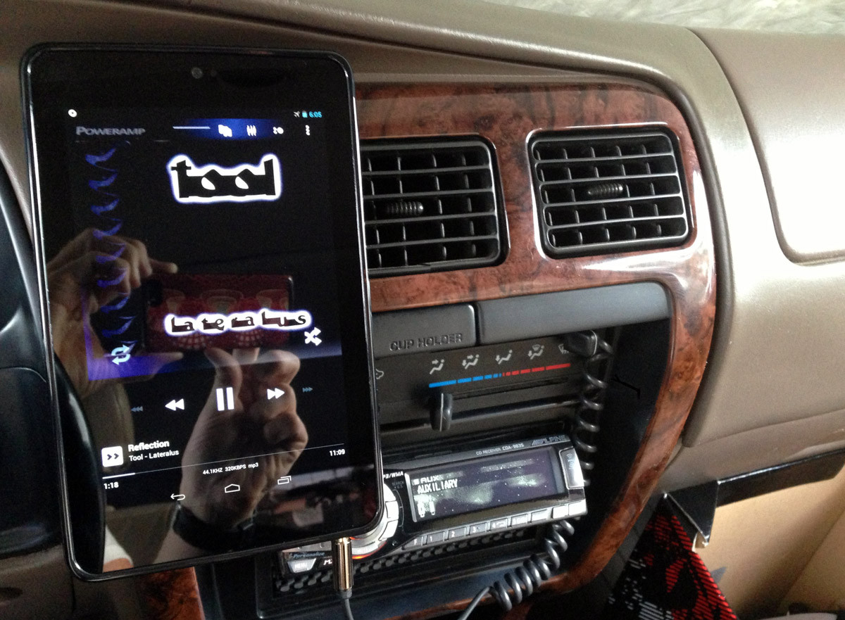

Best for your money, in my opinion is a $150-$200 high quality single din heat unit, paired with a 2013 Nexus 7 ($190), connected to relatively cheap 30-40W RMS speakers such as Infinity Reference. You could build this system for < $500 by buying brand new grey-market gear off eBay. Just be sure to check the sellers rating and the return policy.
Or you could buy a low to medium quality double din LCD for $400-$500 and not even have new speakers.
I run my Nexus7 with my head unit over Bluetooth and the quality is WOW really sounds near CD level. Bluetooth has come a long way in the last few years.
I keep all my MP3s on my Nexus7 and use Power Amp app for Android.
It is mounted and fully removable. Pictures are in my thread, linked in my signature.
If you have the cash then spring for a proper amp but you can always do that later on.

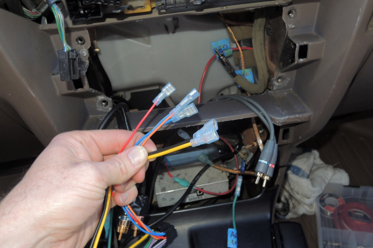

Other advice .... Absolutely run new separate 12v power and ground from the battery, through the firewall and into the stereo area. You will reuse the ACC ON 12v wire but not the (+) power & ground. Also run new speaker wire to each door - it really isn't that hard. I would suggest true 14g so that you are covered in case you want to add a 75 RMS x4 channel amp down the road. By doing both these things you will be able to avoid the dreaded speaker whine that sometimes happens.
I got the Kenwood dpx500bt a few weeks ago and I love it. Does Bluetooth great. And even plays your android music and Pandora and the such through Bluetooth so no need for cables. Got it on Amazon for like $145
Here are some pictures of the Nexus 7 setup .....
One of the pics is with my old head unit --- now I'm rocking Bluetooth so no aux-cable is needed.

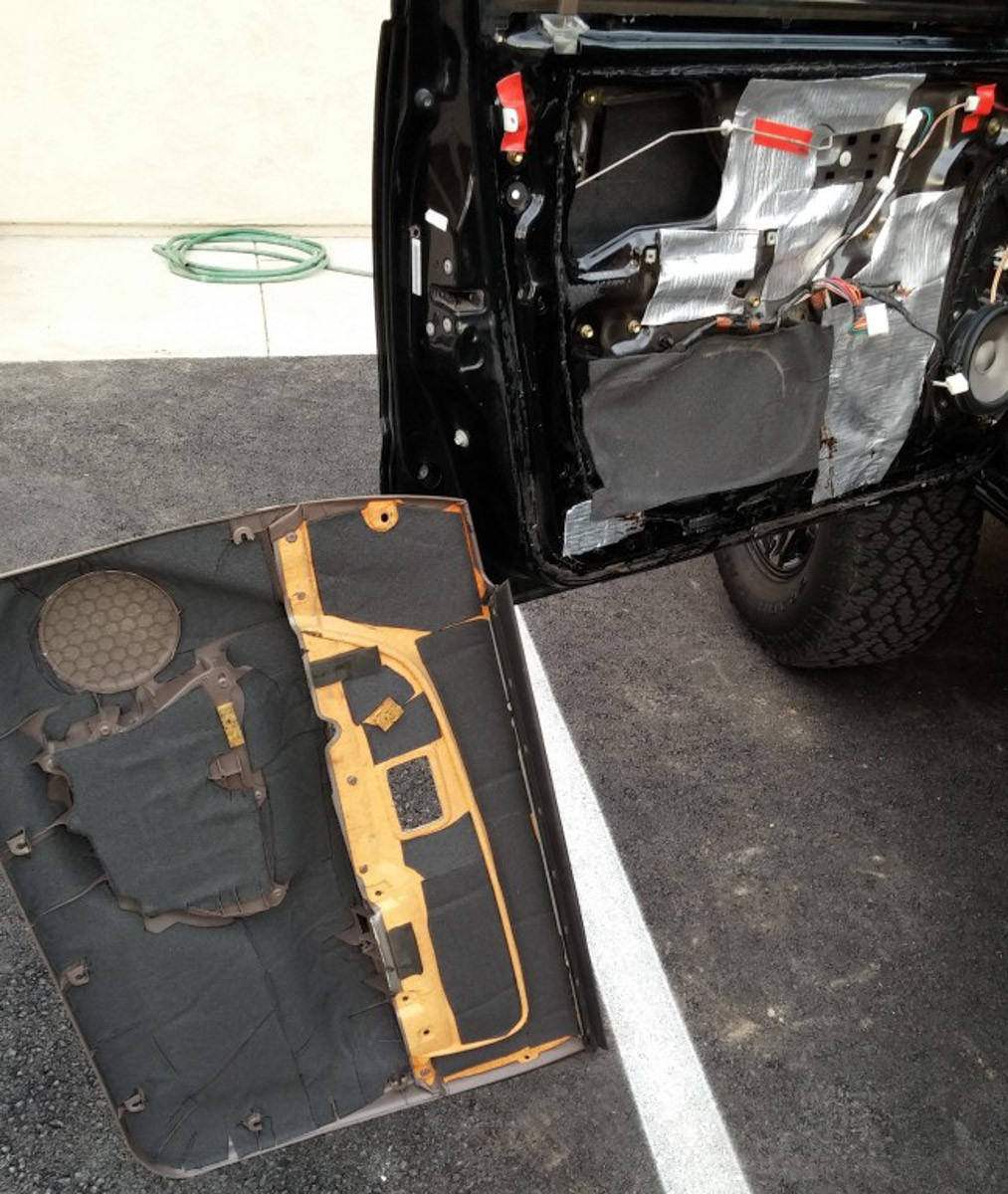

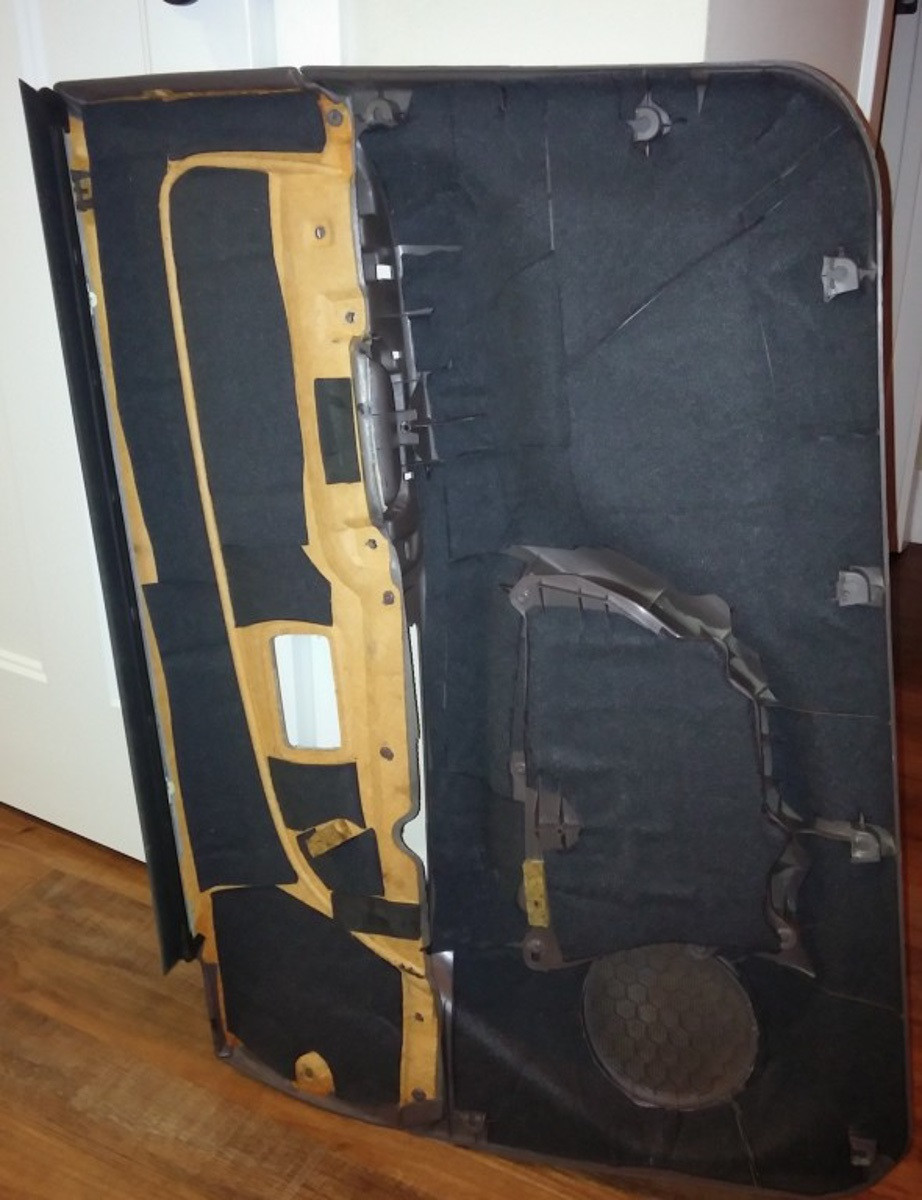

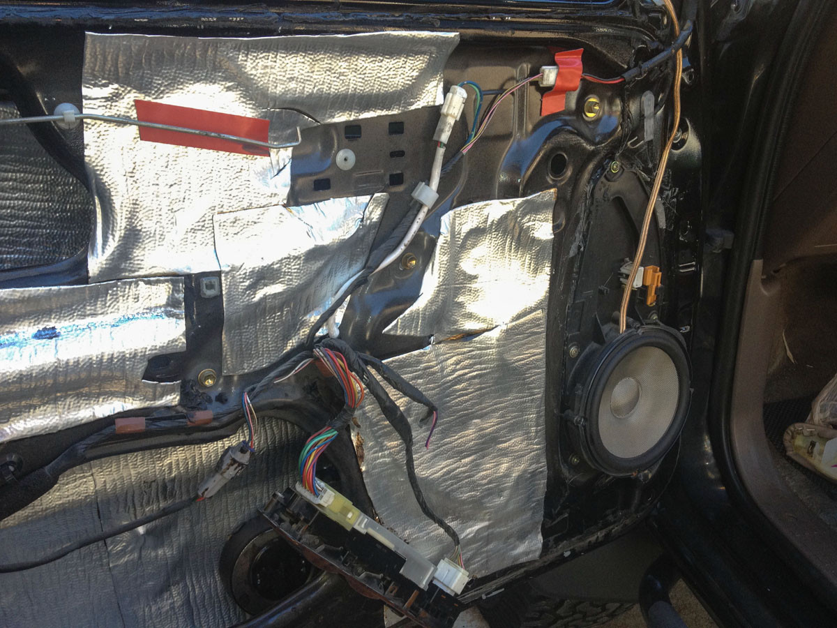

Today I would like to talk about a few Stereo Mod's I've done. I put these speakers in over 2 years ago but last week I had my door panels off and thought I would take some pictures.
The panels are really easy to remove for anyone who hasn't done it before.

1. Sound Deadening Mod - Roofing Material

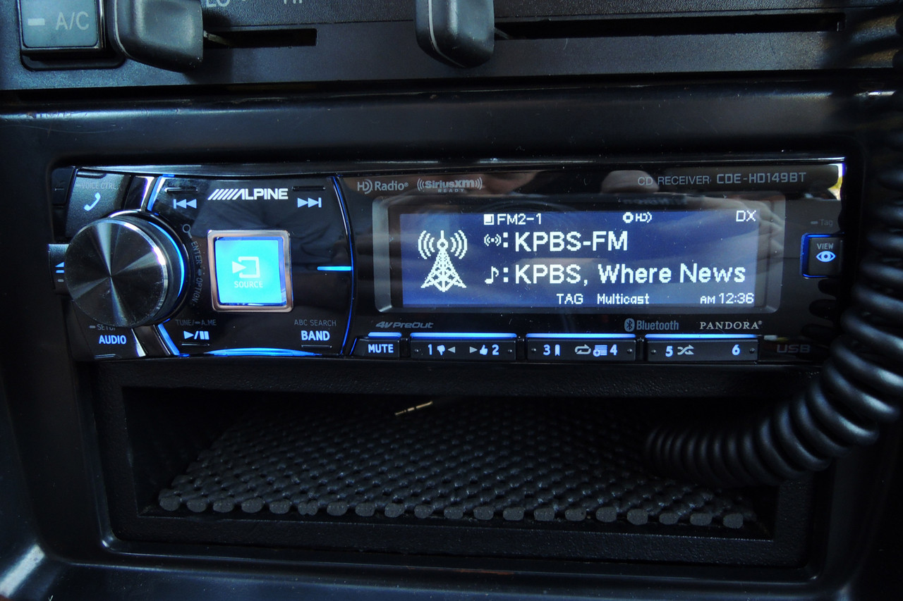

********* Alpine CDE-HD149BT Stereo | Installed Feb. 2014 (3 of 3) *********
This one:
Alpine Electronics of America, Inc.
* 4V Pre-outs (x6)
* No tilt :(
* Decent screen
* HD Radio Tuning Built In (sounds great!)
* High Quality (2013 version) BlueTooth Audio
* Nice big clear buttons
* 109db Signal to Noise ratio ~ translation: amazing audio quality :)
* 3.5mm direct-wire audio input
******** Mounted my Nexus 7 (v2) Tablet *******
I used simple velcro to hold it in place

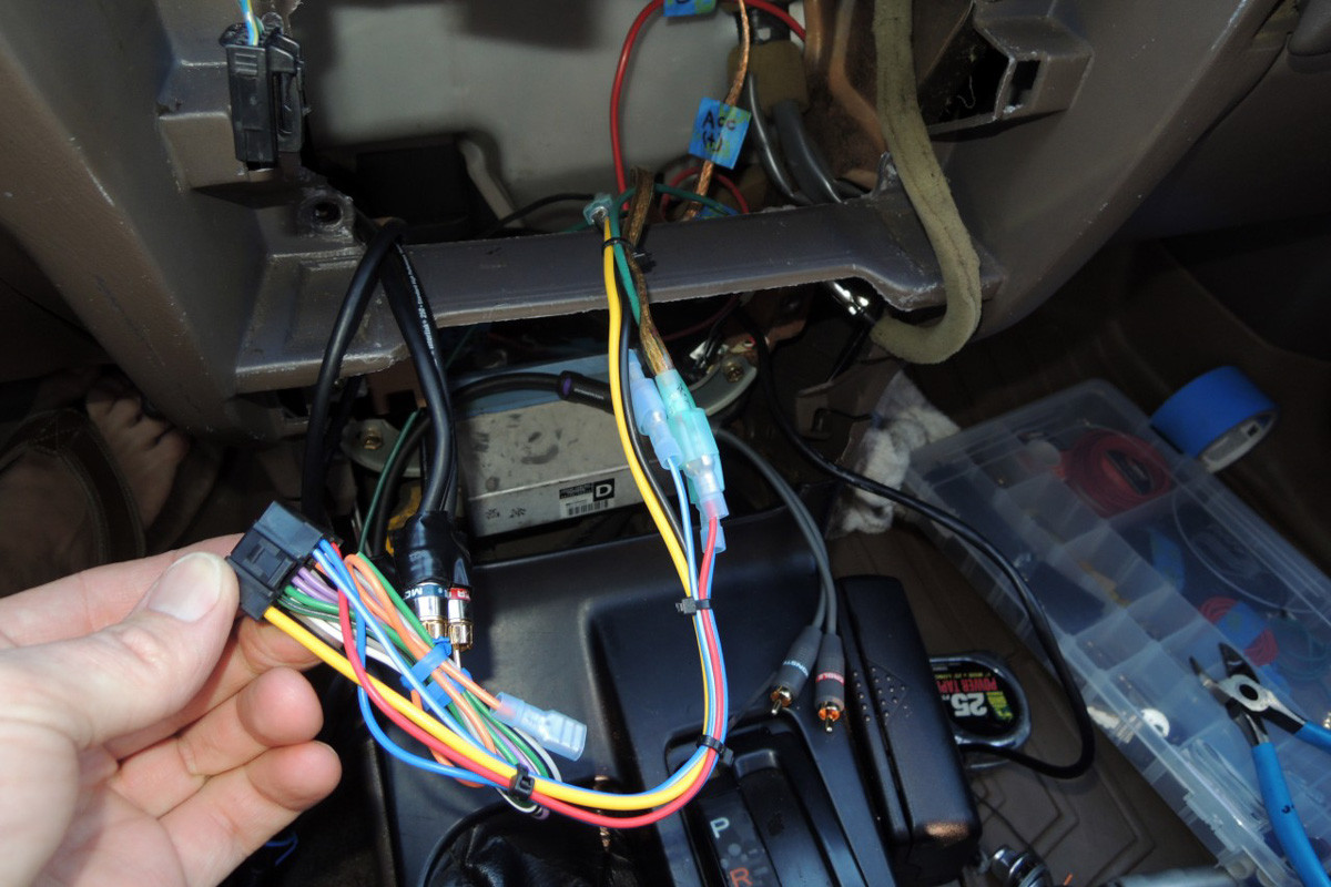

******* Wiring Install Pictures | How To *******

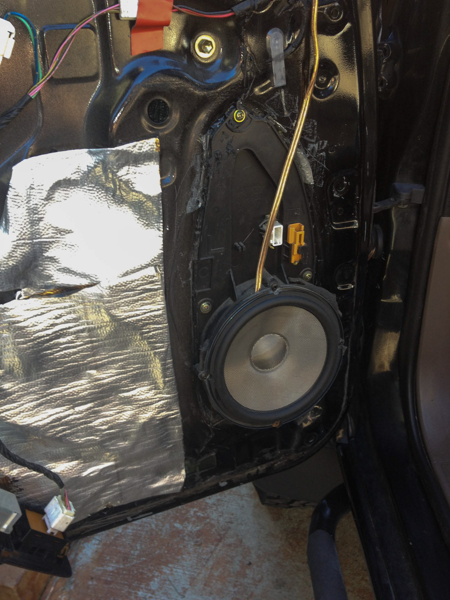

******* Speakers, Sound Deadening, and new wiring ******

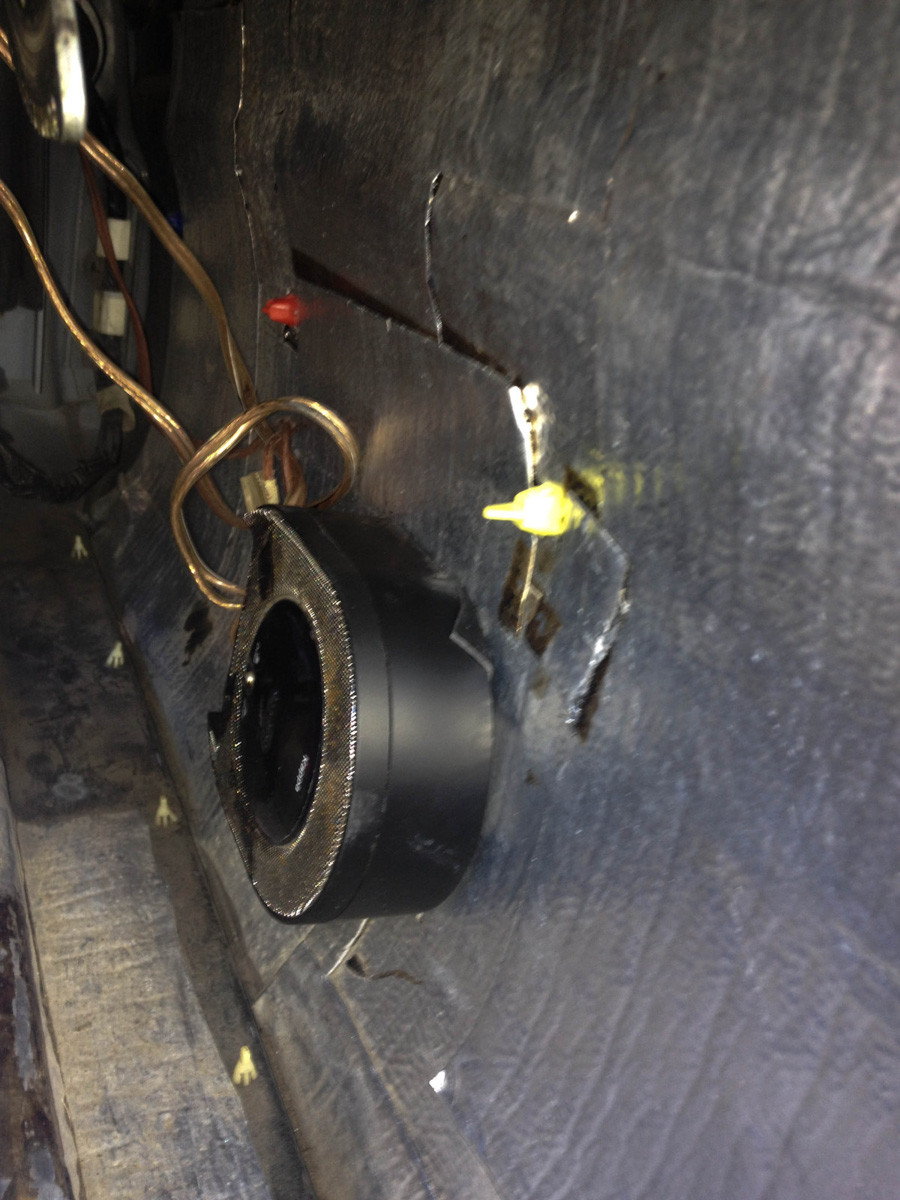

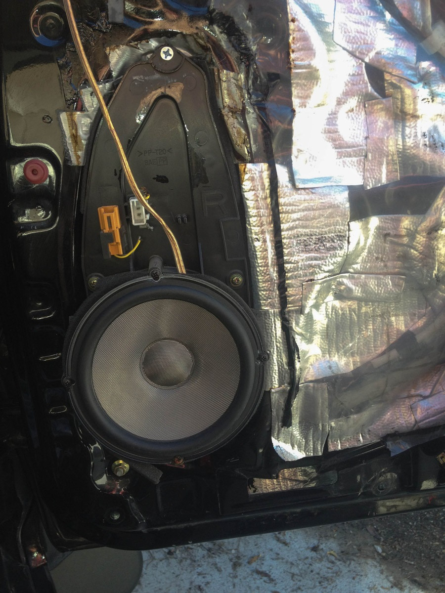

Front Door Panel | 6.5" Infinity Kappa Speaker Set
Infinity Cross-Over Box - This comes with the speaker pair - Install in the door using 3M Double Stick Hardware Tape

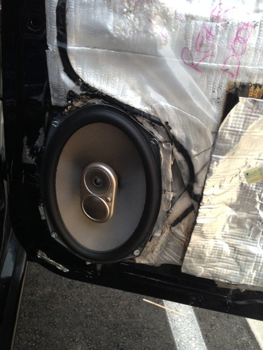

Rear Speakers | 6x9 Kappas | Note: Don't do this, go with 6.5", my magnet is too big and prevents the window from going down all the way!

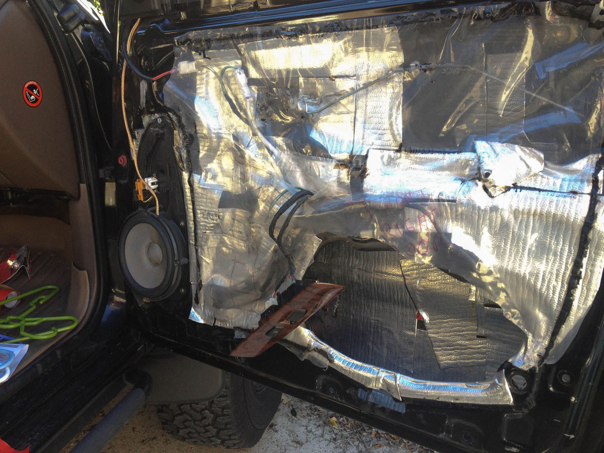

Here you can see the sound deadening material I used as a base layer. It is the cheap roofing material.

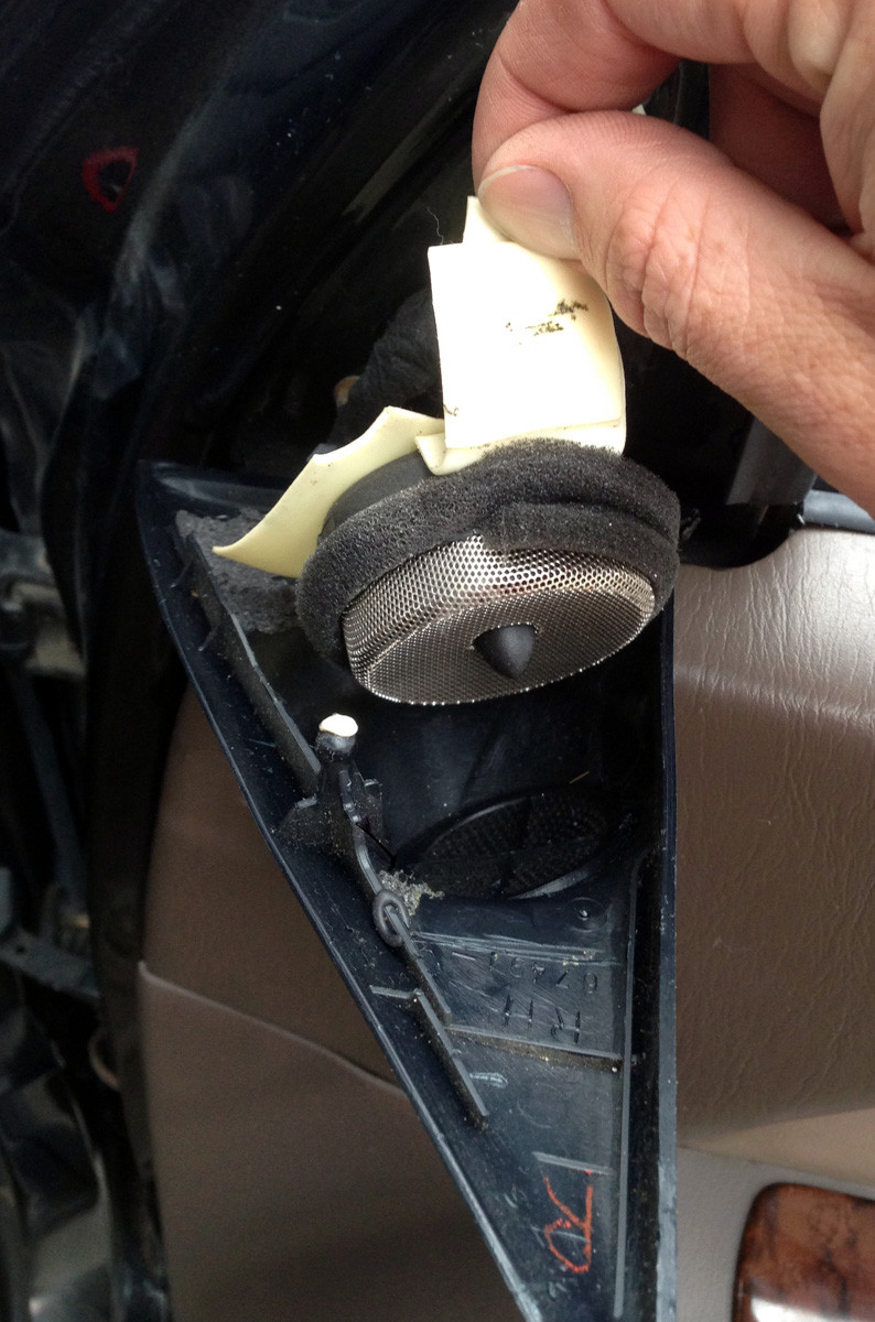

Installing The Front Tweeters
Installing the 2nd Layer Of Sound Proofing Material | Ensolite foam @ $20 yard | I bought 2 yards
