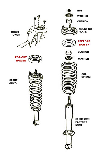

Did you use Cornfed? Evidently the Cornfed spacers go in a different spot than the Toyotec/Daystar? Topout vs. Preload? I wouldn't know- I didn't recieve any instructions or help from Burtman....
Yes, Cornfed. There are threads in this forum with instructions on installing them. I might even have a copy on one of my thumbdrives. I'll take a look and see if I can find anything for you.
Here's a basic set of instructions for installing the FRONT spacers. It is not specific for XREAS, but you can follow all of the same instructions anyway. Instead of removing the front shock completely, you can just support it (don't let it hang by its hydraulic line) and put it to the side. Unfortunately, I'm at work right now, so I don't have access to the good instructions on my computer at home.
Reference picture:
Unless there's something I'm missing, you can install the lift without disconnecting the XREAS line. If you follow the line back from the shock, you'll find a bracket. Take a bolt out and remove the bracket (which is attached to the XREAS line) and you'll have enough slack to do the work in the fenderwell (front). I did this when I installed my springs and spacer. I had to completely disassemble the strut just as you would with your install so I could get the spings in, so there's no reason you'd have to do so. I'd bet money that the shop has a bench mounted spring compressor, which is why they say it can't be done. If you get the small portable compressor (availiable to "rent" for free at most auto parts stores) you can do it all with the lines attached.
For more details, click the link in my sig where it lists my lift/tires and it'll take you to my write-up with probably all the info you need. Look at the write-ups I linked to, and together it should help you (them) get the job done.
