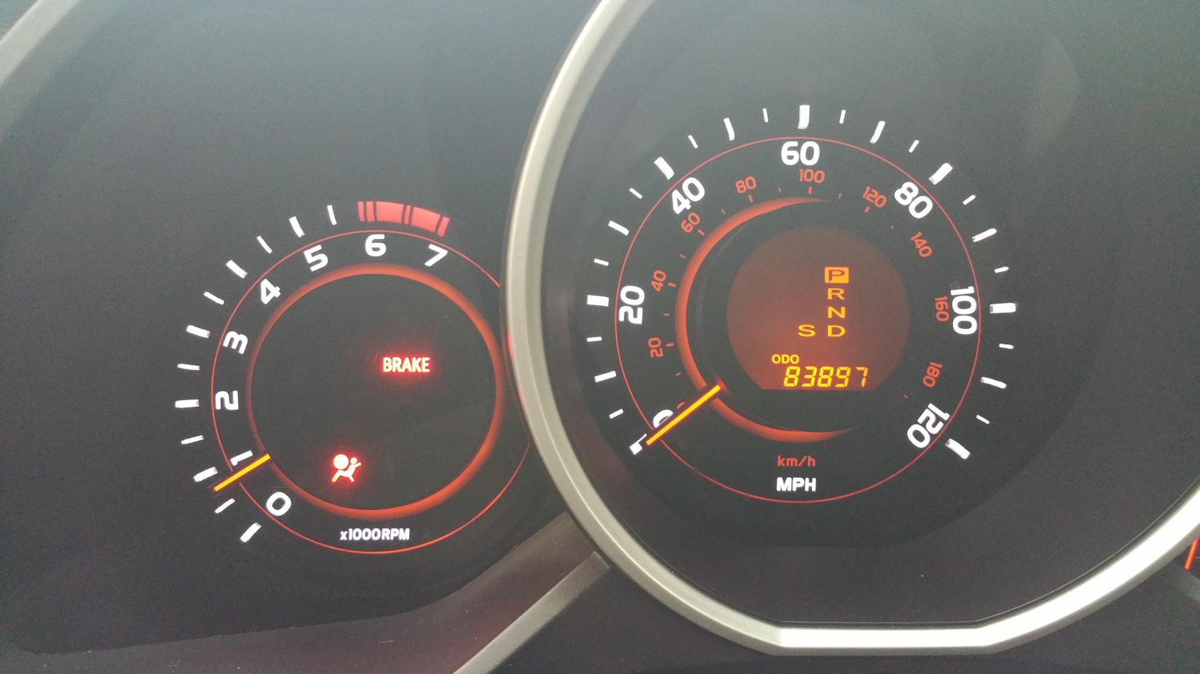

I know this is a thread revival, but my airbag light has been on for a few days now.
see the light in the pic.
Any idea what may be causing this? I've had wet okoles installed for probably like 6-8months now and this is a recent issue...

Mine came on for a few days and went off. Came back on a few weeks later and went off. Then it stayed on for like a month, went off and has been fine ever since.
I know that doesn't help you but nobody could help me figure it out either, lol.

well i now just need to find out if it will pass inspection in TX with this light on... inspection is up in a month...
Well...
You have a TE with the tinted dash plastic.
Take the cluster off and the tinted plastic and cover the light with electrical tape. It'll work to get you passed- ask [MENTION=6163]phillyd2[/MENTION]

lol. yea that will be the first thing i do. its the cheapest solution by far.
Get the TIS software. It will tell you exactly what the problem is. It keeps logs of all of the various ECU's even if the problem fixes itself, you will be able to see that at some point there was an issue.

the light has gone off... i have contracted the [MENTION=65614]Antman[/MENTION] airbag problem...
:dizzy: :sick:
oh well i guess as long as she keeps rolling as long as [MENTION=65614]Antman[/MENTION]'s has, i guess its not so bad.
the air bag light on then no air bag operation .
need a scan tool that reads these body codes.
i have a scanguage II hooked up, it didnt read the code when the light was on. i tried that.
and how do you know it means no airbag operation? just curious if youve had the same issue and got the code run or something.
Any time the air bag light is on that means it has been deactivated due to an error.
look it up this is a standard type operation on motor vehicles.
an example also would be the ABS light on that also would be deactivated due to an error detected.
scan gauge II may not read all codes .
