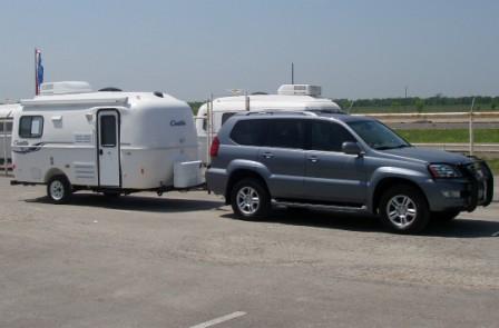

I have a Casita Travel Trailer. It weighs about 3000lb loaded. My GX has no problems towing it. It has a full bath, full kitchen, full bed, and a two person dinnette. It is made of fiberglass so you do not have some of the problems you see with stick trailers. If you want more info, PM me.
TexGX
