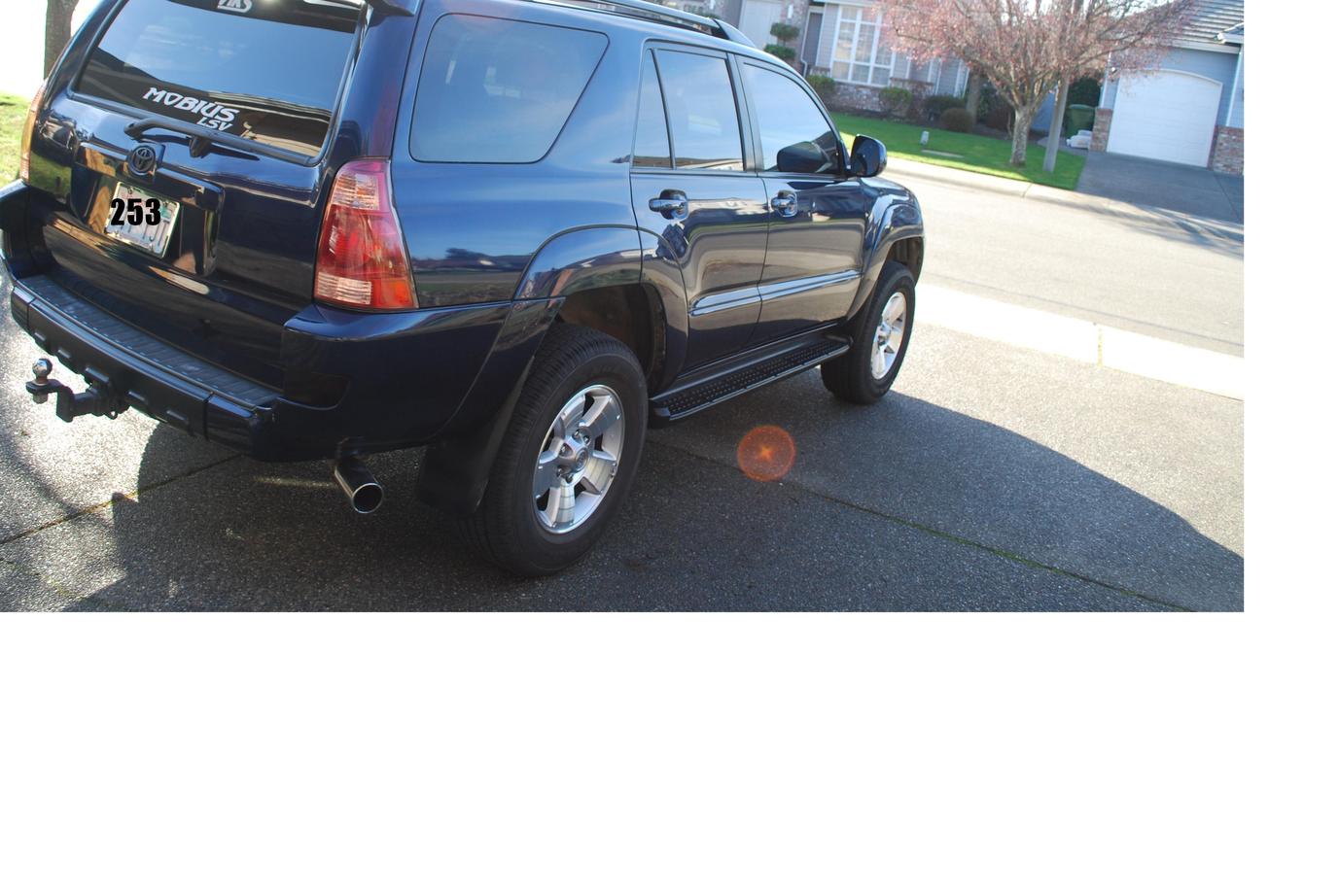

2003 4 runner... right now i have 2.25" coil spacers on the front and a 1" coil spacer on the back... its not near high enough to get the look im looking for when i origionaly lifted it... im a very picky guy and i cant stand how it looks.. because the fronts noticibly higher than the back and honestly to me it looks tacky... id like to get that origional rake back but just a tiny bit of rake.. i know the kits they make are like 2"/1" or 3"/2" or 3"/3" but i still see the same problem in peoples pictures.. that the backs lower than the front...
ive drew out some pictures and did some math and kinda decided what ever kit you do you need to at least go 1/2" over what the heigth of the front lift. anyone with me ?
idealy id like to go with 2" lift coils and put my origional coil spacers on top of that for 4" lift in the front
then in the back go with a 2 or 3" lift coil and use my 1" coil spacer on top of that with new shocks all the way around.
any thoughts of different ways of staggering the stance so that the backs a tad higher than the front on a bigger lift?
ive attached 2 pictures of my problem youl probably see what im talking about!
-thanks

Read some posts from IronCladLou. He went through a similar thing. He's not quite as high as you want but his 2/2 looks great!
I can see how a 2/1, 2.5/1.5 or 3/2 doesn't look right, especially with some gear and a trailer. Starting from 2/2 or 3/3 retains the stock rake just higher.
