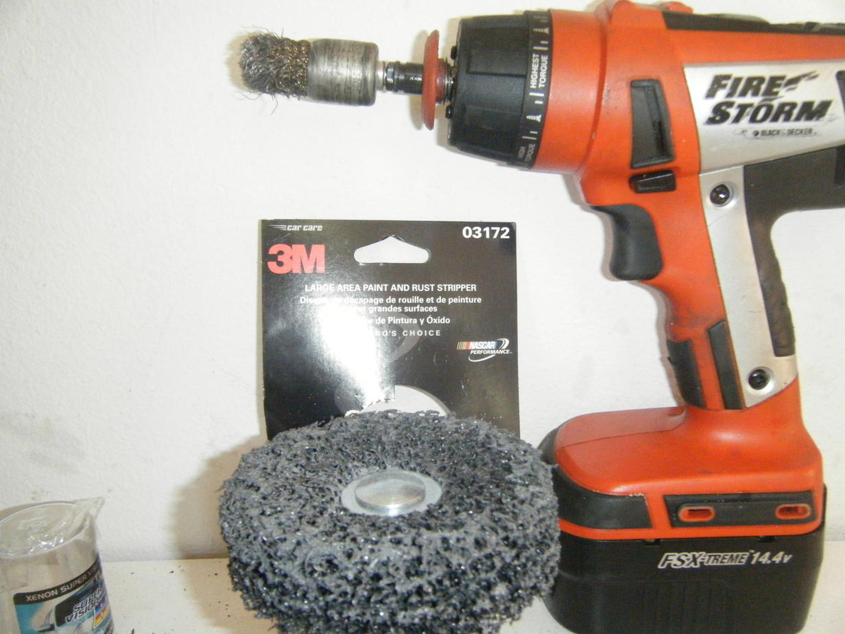

Alternative to sand blasting

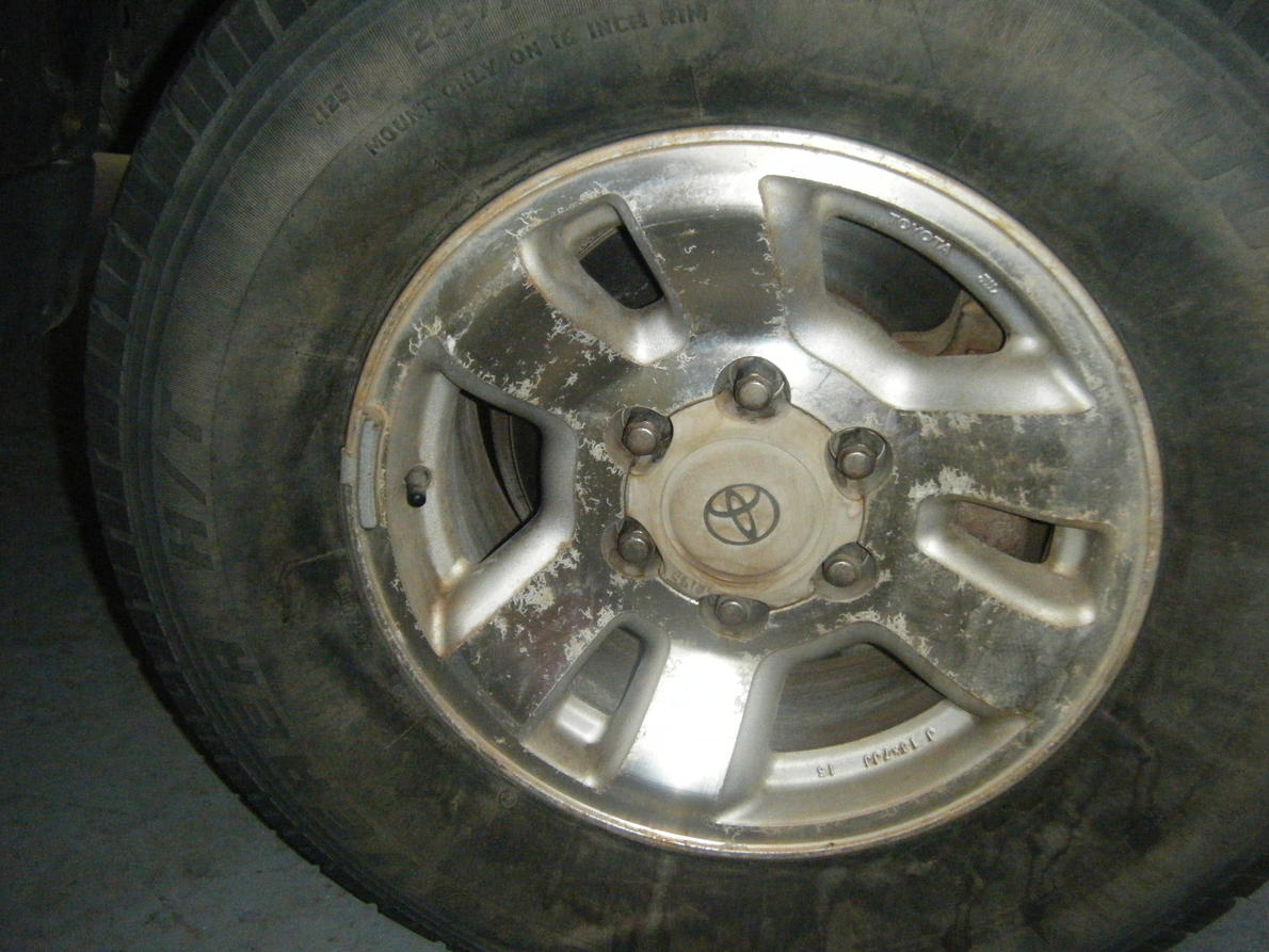

Before

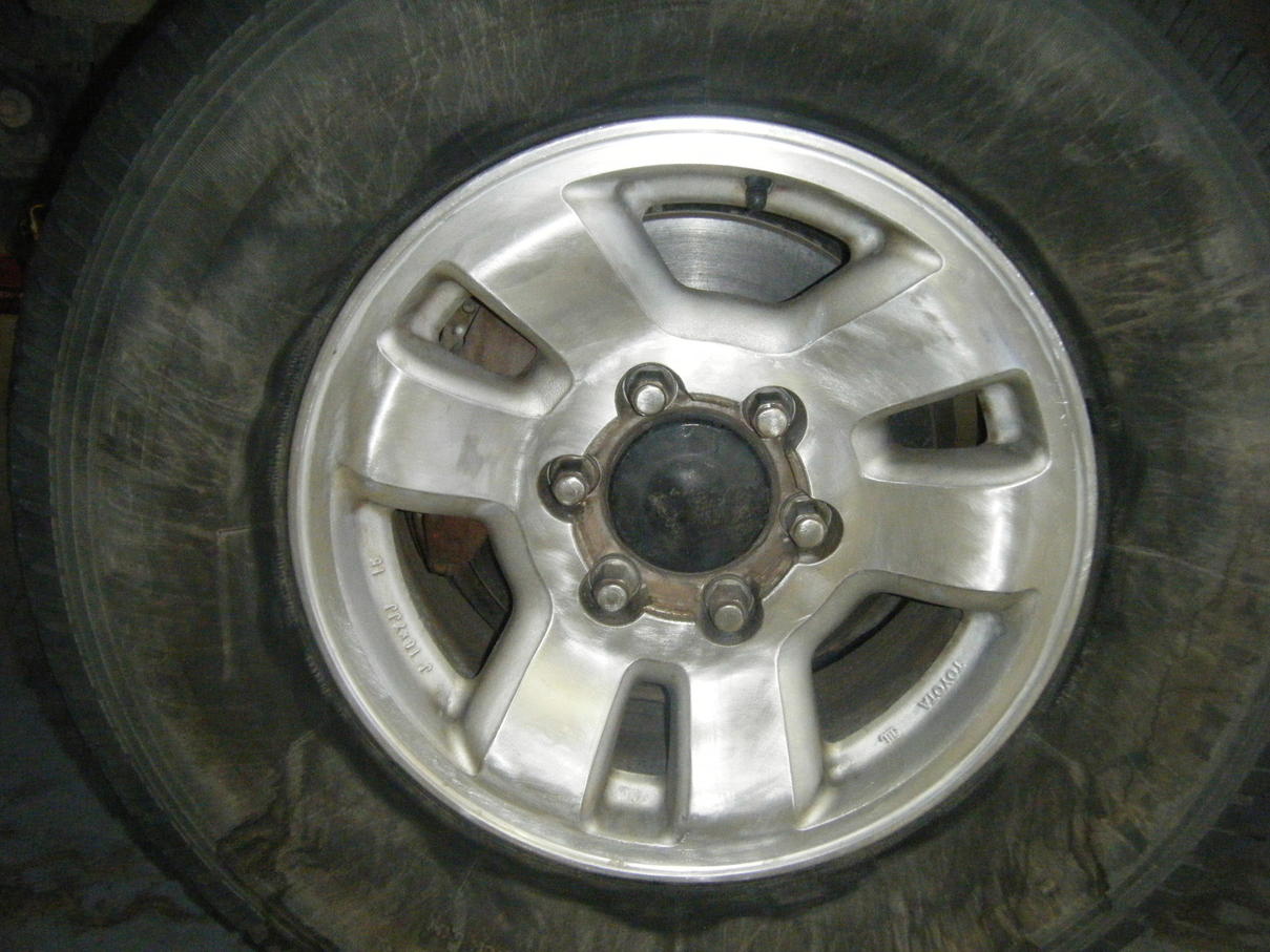

After

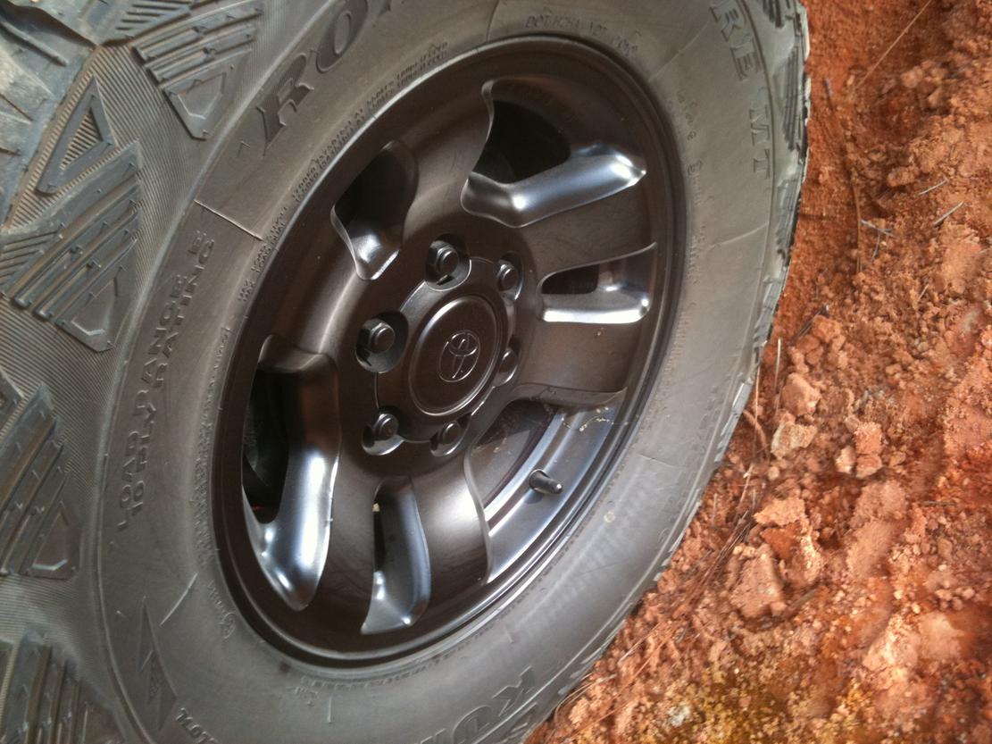

Flat black grill paint
