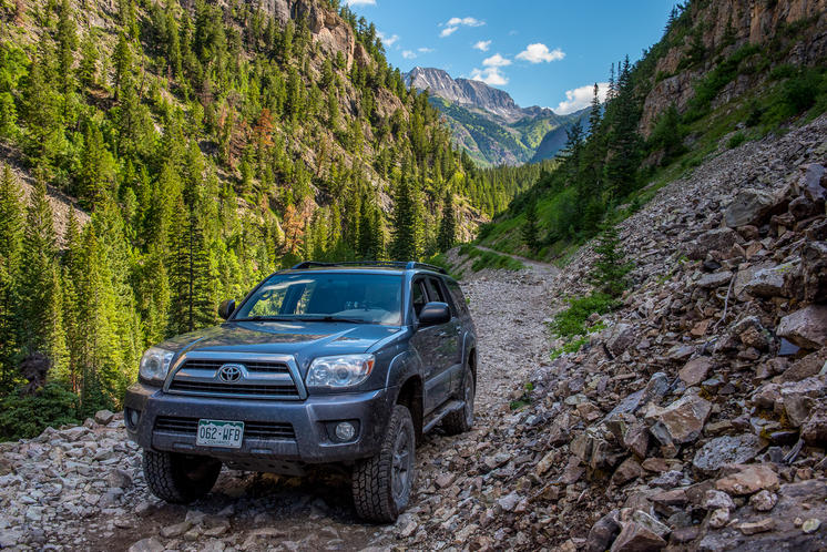

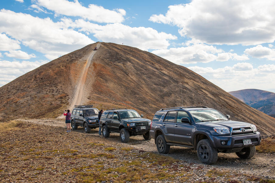

I very strongly recommend the AT3s, they've been fantastic in the sharp rocks of the high mtn passes, solid in mud, and excellent in snow. No stopping them even in our 2 ft blizzard last March, drove around all day digging other people out. Oh yeah, they're good on the highway too, which is 80% of my driving, even if I prefer it were only 20% :)
