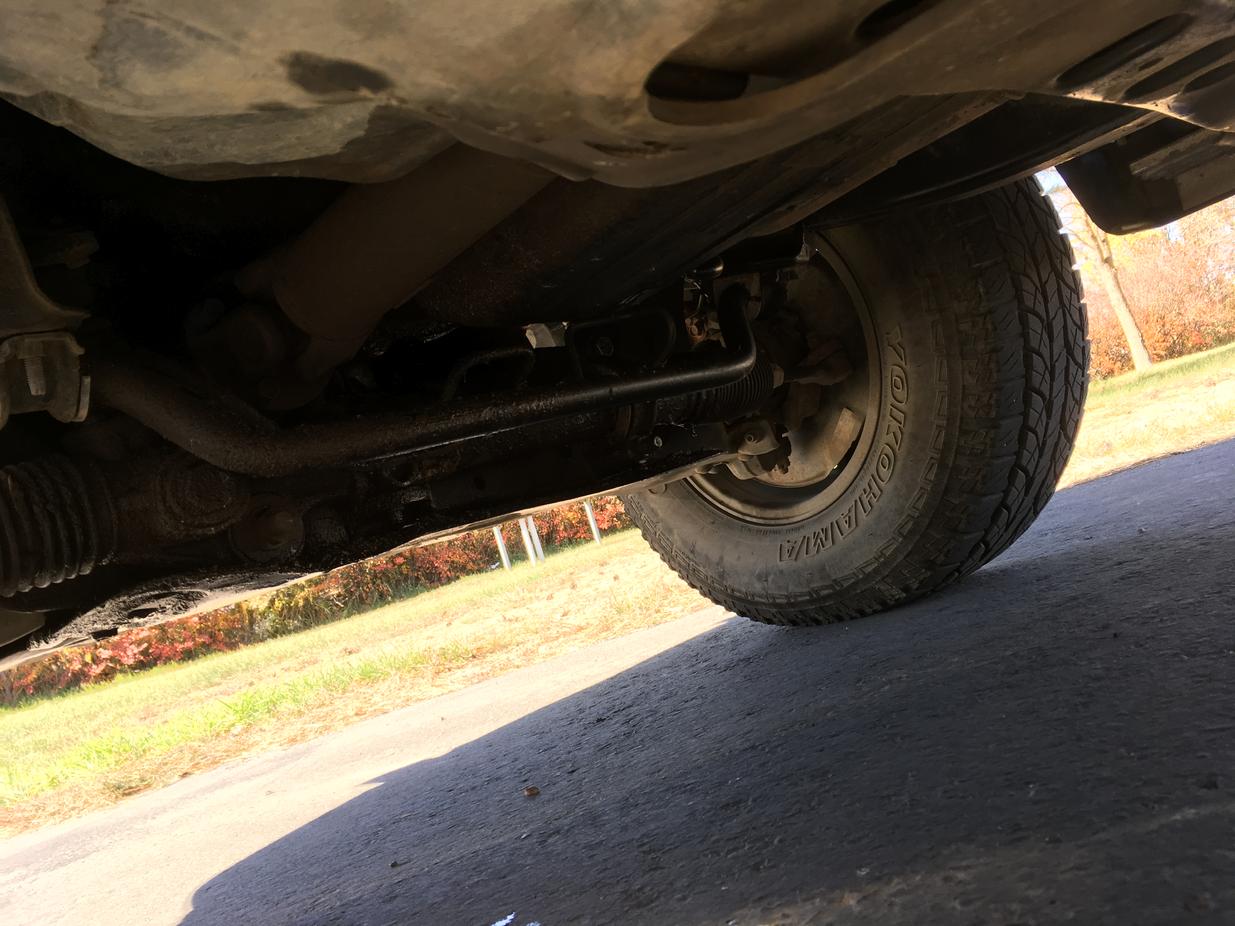

Hi, I am looking at a 3rd Gen for my daughter. I have mediocre mechanic "skills", mostly due to forums like this and youtube. This is a 98, Limited, with rear locker and 225K miles. It is 300 miles away from me (I live in Fargo ND and 4Rs are scarce around here, especially on my budget). This one has spent it's life in WA state and western ND so looks much better than most around here as far as rust is concerned. BUT, it has an oil leak. I would like to hear opinions as to what is leaking and how hard/expensive it is to fix. I know the pic is terrible too but any informed guess is welcome Thanks in advance!
Dan
Pic is apparently from the rear driver side looking forward.

I'm gonna guess what everyone else is going to guess. Valve cover gaskets. These motors are very well known for that specific leak.
It's difficult to say from the picture, but I wouldn't be too concerned about a leak like that. You'll be able to tell just by reaching around the back of the valve covers to see if oil is seeping out.
That looks like it is probably just leaking valve cover gaskets, which is a common maintenance item on the 5z. There are a ton of threads about that repair, and heck, here's a great step-by-step video. It's a fairly easy repair but it takes a little time. Use it as an opportunity to get to know the engine and see the condition of the top of the engine from the inside.
Valve cover gaskets, bad oil changes (oil filter drops oil on skid plate), PS fluid leaks on the rack. Any or all of those...
-Charlie

It's most likely valve cover gaskets as they're a very common leak. Best case it's sloppy oil changes and nothing is leaking.

Could be a rear main but they rarely leak on these rigs. It's most likely your valve cover gasket or the cam plugs/half moons.
Mine's been leaking for a couple years now, I've just been too lazy to fix it. In 3k miles, I don't need to add any oil. It just leaks enough to look like the OP's picture, maybe not quite as bad as that.

They do leak from rear main seal. Op has some miles on. Especially if he changed the oil to synthetic.
I wish our video would have shown how leaky mine were exactly.. but those lines on my steering rack were completely drenched...
I don't think it's sloppy oil changes... my vote is the valve cover gaskets..
So the next picture you should post is inside your engine bay where the edges of the plenums are....
Give us a picture of both sides on your engine
Sure they do, but it's not as common as a leak from the valve cover.

I had the exact same leaking on my rig. I was paranoid it was going to be something major. Fortunately, I have good news for you.
I took about 5 days and did the following on my rig (all OE parts):
1. Removed valve covers.
2. Replaced the valve cover gaskets and spark plug tube gaskets.
3. Removed the half moons, cleaned where they went, cleaned them and replaced with copper RTV.
4. Installed new valve cover screw gaskets.
5. Replaced the PVC gasket
6. Removed the rear "cam covers" (look like a hockey puck hollowed out) and cleaned where they went, cleaned the covers and used copper RTV and replaced them.
7. Replaced the cam shaft oil seals (while doing my timing belt).
8. Replaced the drive shaft oil seal (also while doing my timing belt)
9. Replaced pulleys, tensioner, water pump (and gasket) thermostat, timing belt and drive belts.
10. Replaced oil cooler gasket and oil cooler hoses.
Before I did all this work, I sprayed down the underneath of the vehicle with SuperClean (automotive section at WalMart) and then pressure washed the steering rack and any oil (or oil residue) I could spot. I did this to make it easier to see if there were any leaks while turning wrenches on the truck. After the work, I did the same thing - degreased and sprayed down.
Again, the bottom of my truck looked EXACTLY LIKE YOUR PHOTO. Now, after all the work and taking my time to do it, it is as dry and as clean as a whistle!
